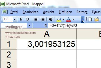

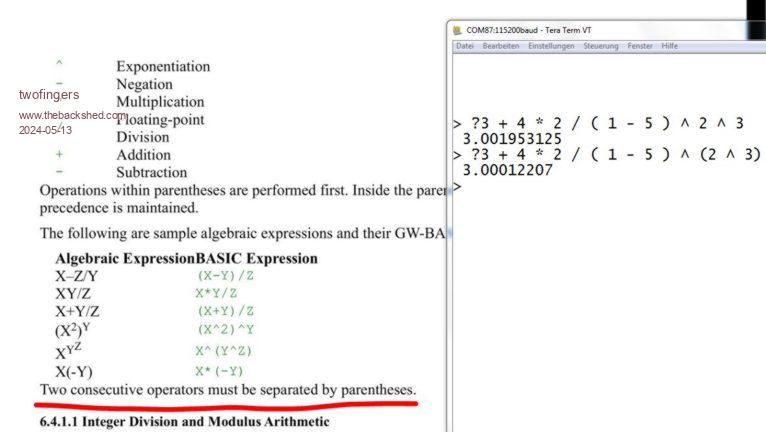

twofingers
Joined: 02/06/2014
Posts: 1769
Posted: 04:48pm 06 May 2024
  matherp said  ... From wikipedia
  Quote  However, when exponentiation is represented by an explicit symbol such as a caret (^) or arrow (↑), there is no common standard. For example, Microsoft Excel and computation programming language ...
https://en.wikipedia.org/wiki/Order_of_operations
I think that a note in the manual is sufficient. IMHO.

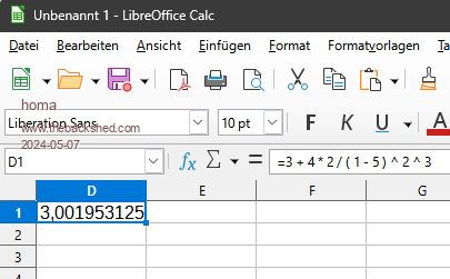

homa
Joined: 05/11/2021
Posts: 672
Posted: 04:52pm 06 May 2024
  matherp said  Reading more into this it appears that exponentiation is conventionally right associative which is what rpn is doing. It is an edge case but I think MMbasic and Excel are probably both wrong if you are going to be purist
Especially since RPN seems to be better defined in the sequence and there are "standardised" instructions for converting to RPN (see above according to ChatGPT).
I also found this: https://www.rpn-calc.com/?q=3+4+2+*+1+5+-+2+3+%5E+%5E+%2F+%2B

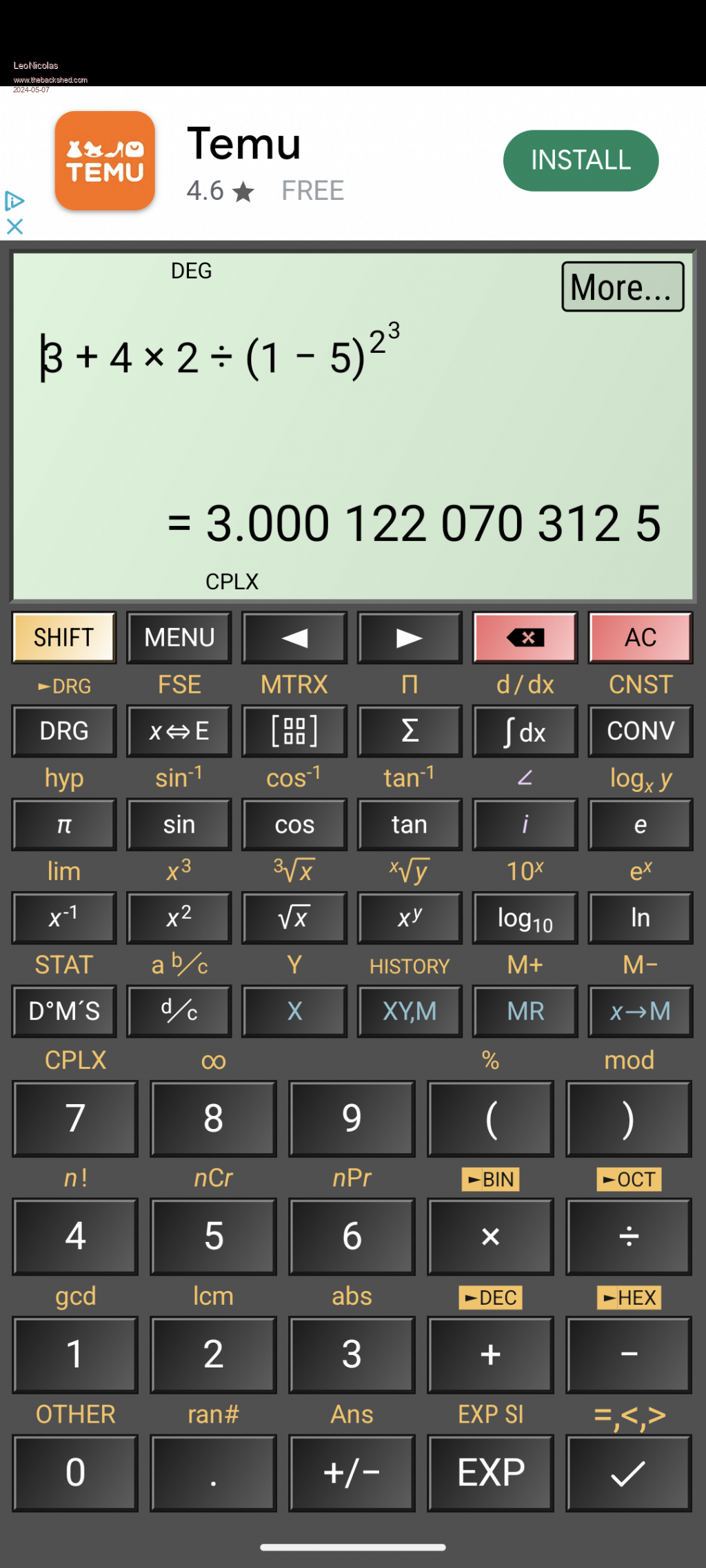

LeoNicolas
Joined: 07/10/2020
Posts: 623
Posted: 09:47pm 06 May 2024
From the android app HiPER Scientific Calculator

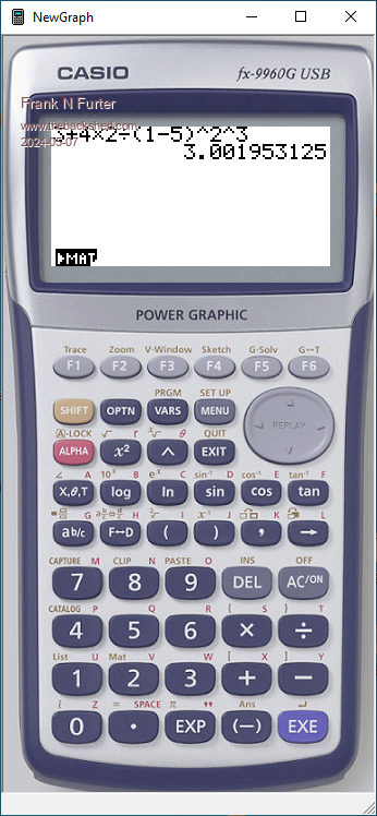

Frank N. Furter
Joined: 28/05/2012
Posts: 1150
Posted: 06:26am 07 May 2024
This is what my CASIO calculator shows:
Frank
