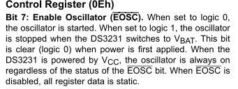

The error appears as if bit 7 in the control register is set to logic 1 and the oscillator is stopped.
This is from the DS3231-manual:
Best wishes! Joachim
