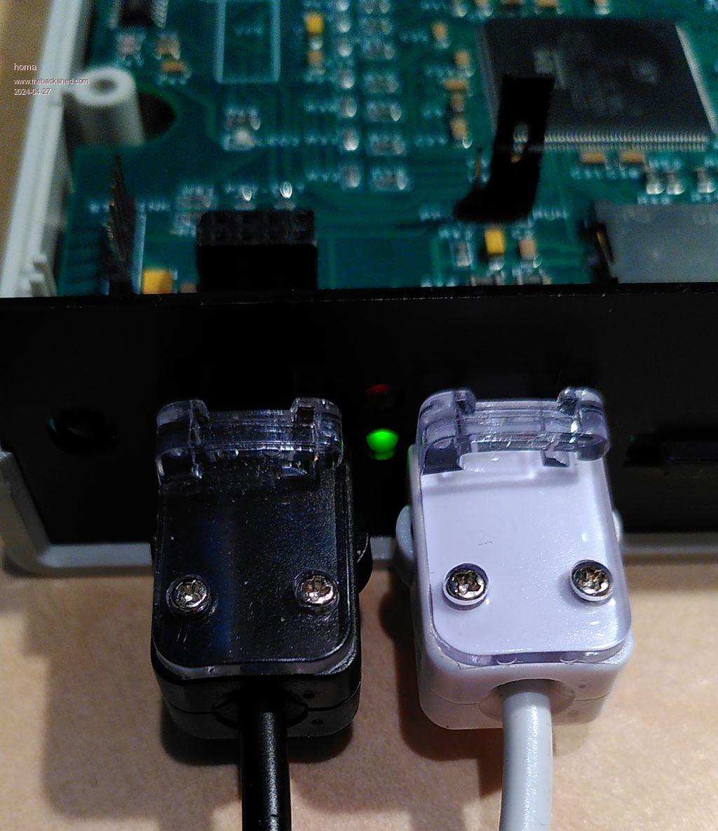

Then I noticed another flaw in the hardware design. You need a tool to get the plugs out of the sockets ;-)
