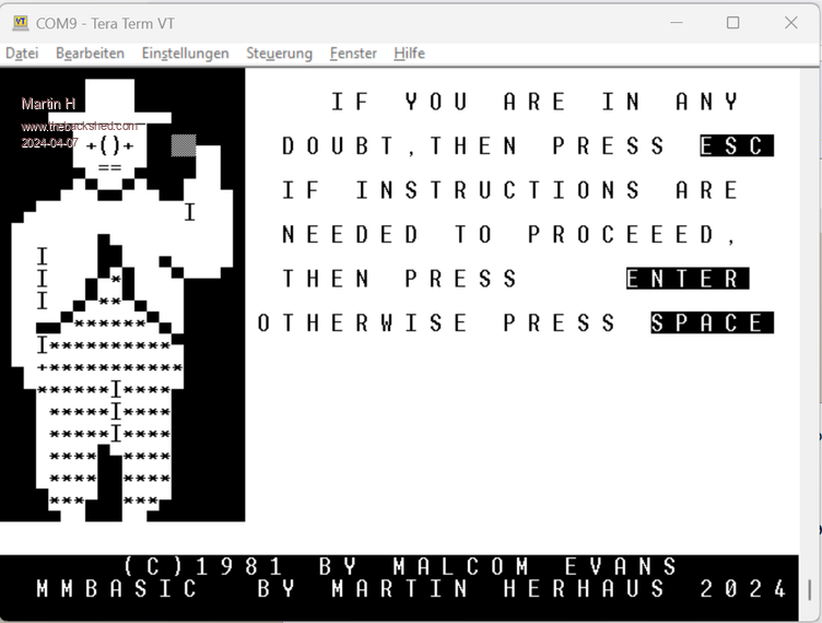

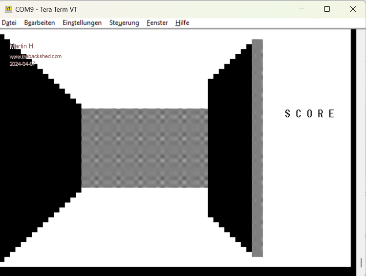

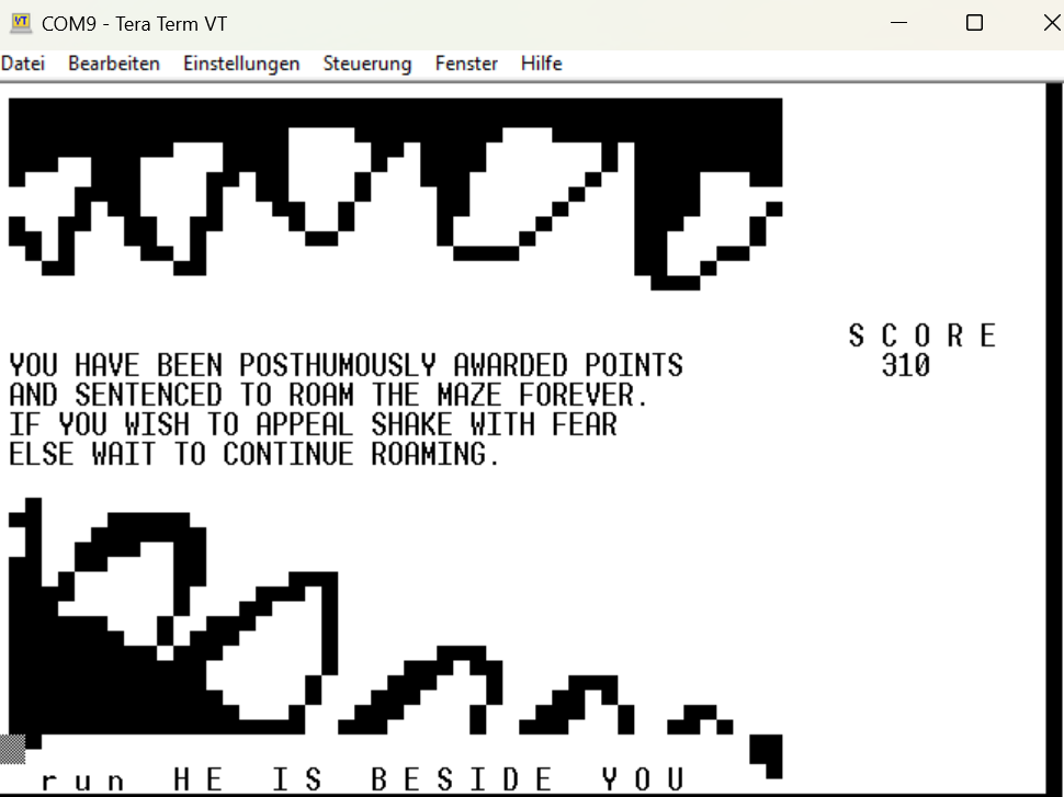

a playable Version of ZX81 Classic 3D Monster Maze for PicoMite, Running in a VT100 Terminal (TeraTerm)

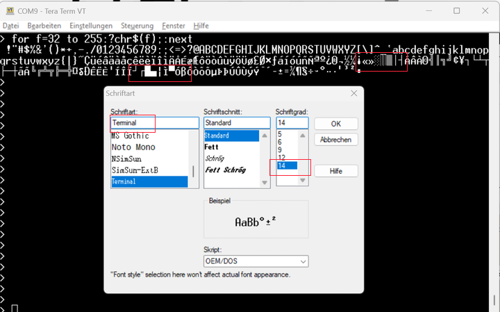

For the correct representation, pay attention that your terminal program uses a font that contains the graphic symbols in the range above 128.
Especially CHR 176-178, 219, 220 and 223 are important here.
I Use a Font called TERMINAL
