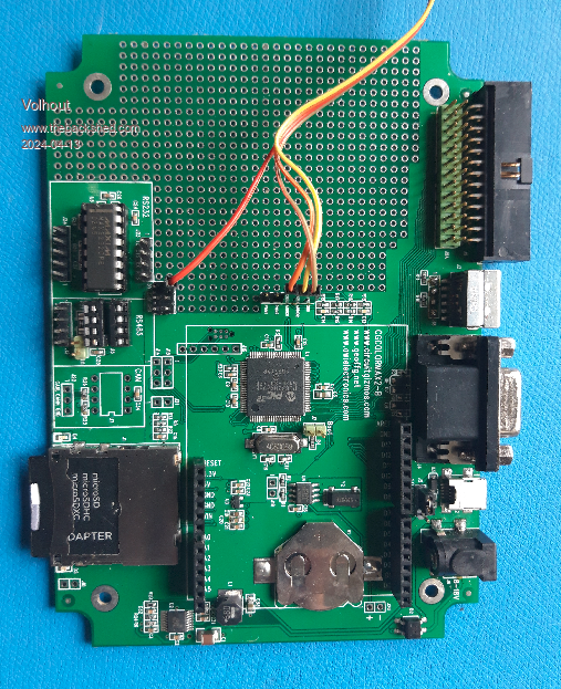

You are not the first to confuse the GCCOLORMAX2 with a COLOR MAXIMITE 2.
But here it is, in all it's glory...
As with your PID algorithm, the output most likely is send to a PWM that controls an H bridge and drives a DC motor. In case of a stepper motor you have to drive the coils in software. If you have a 400 steps per revolution motor, and you want to drive it at 30 rpm, you have to control the coils at 800 pulses per second. And when you get close to it's maximum speed, your timing must be accurate, otherwise it misses steps.
Typical stepper motor applications do not have feedback in form of an encoder. So missing steps is deadly. But no feedback means...no PID. There is only forward control. That is why DC motors have taken over, using encoders.
It was my suggestion to avoid the real time (creating time accurate step pulses) from the relatively slow CGCOLORMAX2, and have an arduino/pico with dedicates control software control the motor. So you only have to send coordinates and commands from the COLORMAX.
But -all in all- Allie is not responding anymore. I fear we are only brainstorming, and he lost interest. Let's stop this until there is a sign of interest from his side.

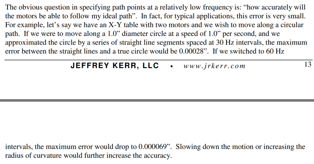

There's a lot of misunderstanding about this stuff. Motor-update rate is one thing but trajectory generation is another. Compared to code execution, machines are slow.
Many high-end CNCs only update their trajectories every 5ms.
Incidentally, was recently chatting with a Kuka-Robotics engineer and I was surprised to learn that their trajectory-update-rate is 14ms...but then again, the mechanics take time to respond.
Here is a snapshot of trapezoidal profile running on the H7 @2ms. It's state-machine stuff and so very little code is being executed at any time. Even this is overkill due to mechanical time constants.
S-Curve acceleration is hardly any different. No sweat for the H7.
    inc tim,.002
     select case motn
       case ACCEL
         mvit=acel * tim ^ 2
         cpos=cpex+(mvit*drc)
         if st then
           dcds = mvit + dd(blk)
           'dest=dcds
           motn=DECEL
         endif
         if mvit=> acds then
           if ds(blk)>0 then
             motn=SLEW
           else
             motn=DECEL
           endif
         endif
       case SLEW
         mvit=acds+(spd*(tim-ta(blk)))
         if st then
           dest=dcds
           motn=DECEL
         endif
         if mvit=>slds then
           motn=DECEL
         endif
       case DECEL
         inc tmptim, -0.002
         mvit=dcds-dcel * tmptim^2
         if tmptim <0.002 then
           'mvit=dcds
           mvit=dest
           motn=0
           inmo=fals
         endif
Banging-out pulses to a motor is something else and it's where the high-speed is required. No problem for servo-motors because all that happens is the command-position, presented to the PID, simply increments.
The generally accepted ideal PID sample-time is 1KHz (10*mechanical response time).
This is the default for many CNCs, including LinuxCNC. So, contrary to popular belief, driving closed-loop servos requires less computing power than banging-out pulses to an open-loop stepper.
PhenixRising
Joined: 07/11/2023
Posts: 2104
Posted: 05:48pm 13 Apr 2024
When interpolating between low-frequency path-points:
