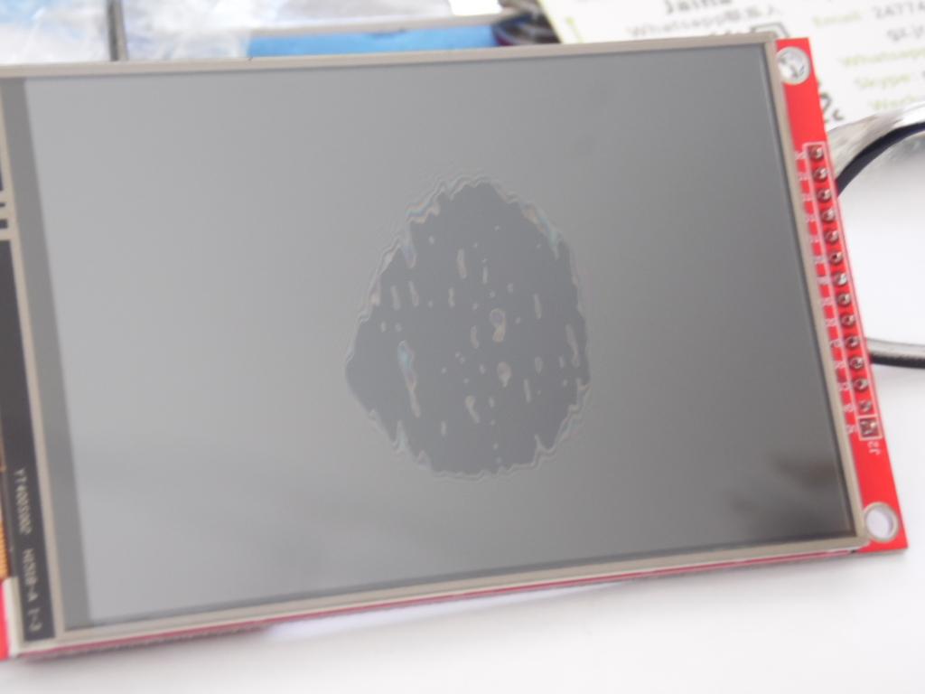

I received a new LCD Display and the screen had a large blemish in the middle. I complained and the seller sent a video of how to fix and it is so simple. Others here may already know but I was amazed at how easy it was. I can't upload a video but you hold the screen between thumb and forefinger of both hands, top and bottom of the glass and squeeze hard. Two or three squeezes in different places and the mark was all gone.

This was the mark.

It is not compressed as pushing on the glass, its squeezing the sides together.

Maybe not such a simple fix, each morning the blotch is back and I have to fix again.
