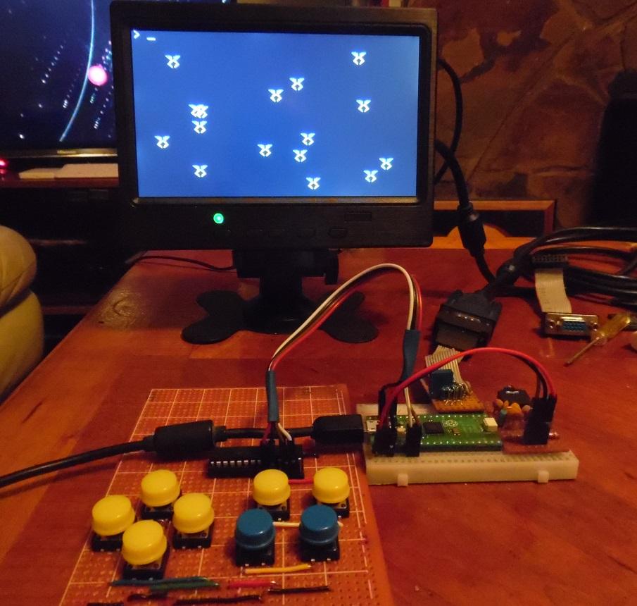

Posted: 08:16pm 07 Apr 2024
hi circuit, here's a test prog to read 8 buttons.vga display
mode 1
option autorun on
OPTION EXPLICIT
OPTION DEFAULT NONE
dim integer porta_bits,portb_bits
const mcp23017 = &h20 ' A2, A1, A0, R/W all connected to 0V
Const i2caddr=mcp23017
const IODIRA = &h00 ' Port A IO Direction register DEFAULT = I/P
const IODIRB = &h01 ' Port B IO Direction register DEFAULT = I/P
const IOCON = &h0A ' IO Expander config register - address &h0B accesses  same register
const GPIOA = &h12 ' Port A General purpose register
const GPIOB = &h13 ' Port B General Purpose register
const OLATA = &h14 ' Port A latch register
const OLATB = &h15 ' Port B latch register
const GPUPA = &h0C ' Port C pull-up register
const GPUPB = &h0D ' Port B pull-up register
I2C WRITE MCP23017,0,2,IODIRA,255 ' set direction to input
I2C WRITE MCP23017,0,2,IODIRB,255 ' set direction to input
I2C WRITE MCP23017,0,2,GPUPB,&hff ' set weak pullups on all
Font 5
CLS
get_portb_bits
text 0,20,bin$(portb_bits,8)
text 0,60,str$(portb_bits)
Pause 100
sub get_portb_bits
I2C WRITE MCP23017,0,1,GPIOB ' set the register to read
I2C READ MCP23017,0,1,portb_bits ' read the B port
end sub
