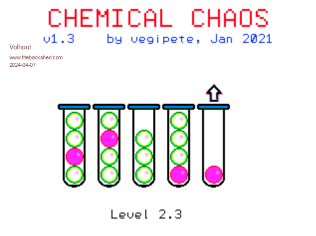

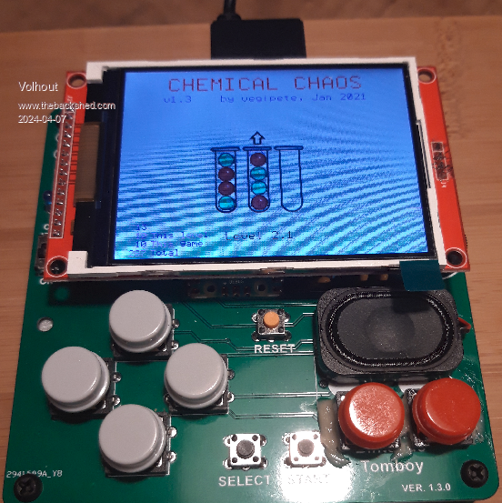

ChemiChaos
In 2021 Vegipete released ChemiChaos for CMM2. It is a game where you move chemical droplets to the right container(vial) to make the lab safe.
At that time I played the game until the last level, spend a whole evening to get that far,
I have ported the game to PicoMiteVGA and Game*Mite. Of coarse adaptations had to be made since the graphics resolution for PicoMite (VGA and ILI9341 LCD used on Game*Mite) is only 320x240 for color. One of the most dramatic is the use of the build in text font. The font in the sprite file was barely readable on LCD screen when scaled to fit the text.
The list of changes:
- I scaled the spites file to 50% in MS-PAINT for LCD
- For VGA I re-painted vials and droplets in 16 colors palette.
- I removed MOUSE from the game, there is no mouse support in PicoMite.
- I added the support for Game*Mite buttons and Menu.bas.
- I centered the vials on screen
- Many, many coordinate changes to fit everything hardcoded to the 320x240 screen.
Quirks:
VegiPete added 2 lines to the mouse cursor sprite file to store keyboard clicks and mouse clicks. I left this in, since somewhere in the future is the addition for a nunchuck, that needs a mouse cursor. Currently the mouse cursor is not used at all.
The software is working on PicoMiteVGA V5.08.00 and Game*Mite V5.08.00. The device specific setting are using MM.DEVICE$ where "PicoMite" is used to select the Game*Mite and "PicoMiteVGA" for the VGA. For other platforms adaptations will be required.
To make use of the 16bit color of the LCD, the game does not make use of framebuffers and sprites. It copies part of the actual screen in memory buffers using BLIT READ and BLIT WRITE. As a side effect the start of the game shortly shows the sprite file.
VGA
You pick up droplets, and drop them again with <SPACE>
You move between vials with left and right arrow keys
You restart a level with R
You toggle the statistics ON/OFF with C
You quit the game with <ESC>
Game*Mite
You pick up droplets, and drop them again with B
You move between vials with LEFT and RIGHT buttons in the cluster
You restart a level with A
You toggle the statistics ON/OFF with START
You quit the game with SELECT
For the "cluster lovers": you can also pick up and drop with the UP and DOWN buttons.
Unzip below file to SD card (B:).
In Game*Mite, use the file browser to start "Chemichaospico6.bas"
Happy gaming....

Tested on Game*Mite.
great realization, fun to play thanks for that

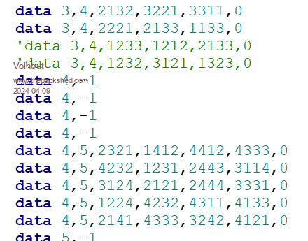

  Volhout said  3/ I think the easier levels have too many "random" generated configurations to keep them interesting. I would remove some of these. But again, this is Vegipete's game, and I may need to consult him. I myself find it boring to spend so much time in the easier levels.
I haven't played it enough to notice. I assumed that the levels were always procedurally generated from a fixed seed, in which case implementing a mechanism to skip to a particular level (once you knew the code) would be possible with work.

The levels are in data statements at the end of the program, lik this:
The lines that have a "-1" are randomly generated. The other ones are specific for their complexity or cleverness. I guess I would remove some of the random ones. Especially the ones with few vials, since they are not challenging .. too much alike.
P.S. The ones commented out, are so by VegiPete. Maybe he was not sure if they can be solved.
