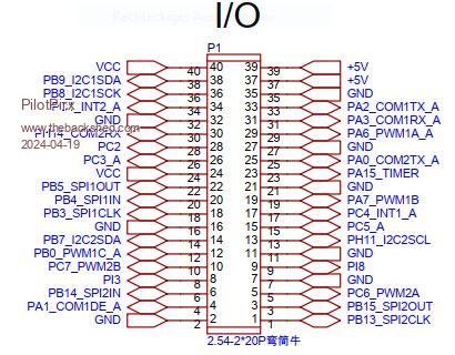

My CMM2G2V2 board has also arrived and is working perfectly. The Microsoft mouse also works perfectly. The picture is razor sharp. The system only hangs (frozen, have to reset) from time to time with subdirectories of my SD-card (which works in the old G1). I still have to test it with other SD cards.
I have only noticed that the I/O pin assignment corresponds to the CMM G1 again. The 180 degree rotation of the G2 is no longer necessary.
But the PIN-numbers are switched. Pin1 is now Pin 40 in schematic. How to set the Pin now? With the old system?

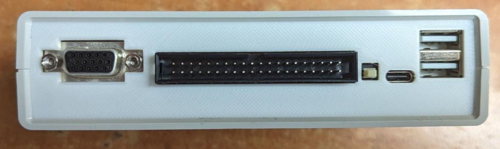

I also tried a PS2 mouse. In my first board I used the USB mouse chip but never get it working, so I was really exited to see the mouse working. And it did. Unfortunately, the interface is not very stable. After some clicks in the file explorer I got garbage on the screen and the machine finally froze. I will check this with another board later again.
There is onne thing, that is suboptimal. The on/off switch is difficult to operate without an extra tool if an USB-c cable is connected.
Shouldn't a keycap like this help?
https://images.app.goo.gl/omCwqYFTLvCYfKBK6
Do you need all 5 boards or would you part with one? Just send me a PM. Gladly also in German.

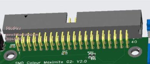

The pin assignment is not as printed on the board. If you look on the back, pin 40 is upper right (where the arrow is)and pin 1 is down left. I measured this with a voltmeter- its like first Gen CMM2. But the print on the board is vice versa.
And Pin40 in the schematic was previously Pin 1.
Here the new pinning
and here the old one:
same functions, but pin numbers switched
Edited 2024-04-19 18:02 by PilotPirx

Posts: 12057
Posted: 09:29am 20 Apr 2024
Sorry about the confusion. The boards made from the gerbers published on this thread should have the same pinout as the 1.5 G2
The two G2V2 development boards sold to PilotPirx and stoke_ferry had the G1 pinout as a result of me copying the wrong layout. I had forgotten I made this change between the prototype G2V2 and the final version as above and should have communicated this to the two recipients

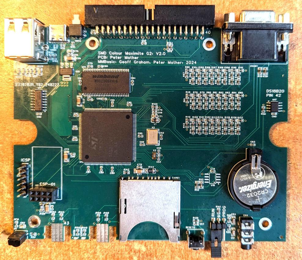

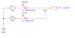

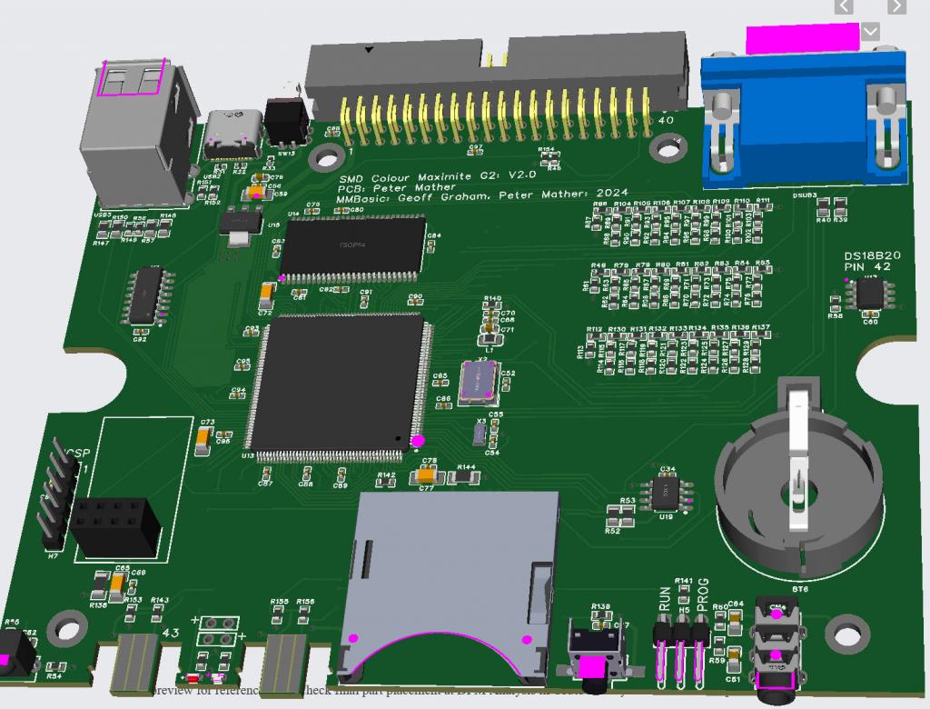

I have a question to the Status LEDs.
I currently try to integrate the CMM2 in a nice retro housing and the last step is to adapt the LEDs to the new housing. But I have problems to access the Drive LED control signal. I found these connection points in the board, but they are connected between the LED and the resistor to GND, so I get only signal too small for my circuit. I need at least TTL levels.
What are these connection points for?
They are not mentioned in the schematics
I need to connect to the positive pin of the Drive LED but it is a very small spot and close to the board edge and the Nunchuk. Not the most ideal place to solder a cable to.
If I bridge the LED, will the port be able to handle the increased current?
Any advice is appreciated.

Posts: 9238
Posted: 07:49pm 04 May 2024
I'm not sure of the CMM2, but I doubt if the LED signals are at 5V anyway, so not TTL level. They are more likely to be 3V3. I can't open the schematic at the moment to check.
Have you considered making light pipe out of polycarbonate rod? I've done it a couple of times and it's very effective.
