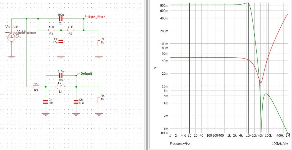

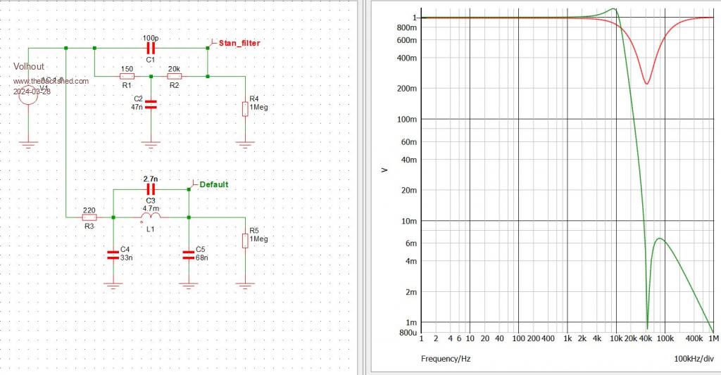

It is a nice filter, that definitely rejects 44kHz. But the rejection is not as good as the LC filter that we use now. See graph. The red (your filter) has a dip at 44kHz, but it is not as deep.
But what is more important. The output impedance of the filter is quite high. You need an opamp or buffer amplifier before you can connect a headset or audio system. This is an example with 1k ohm load. You see that the red curve in general is much lower (so less audio).
And with 32 ohm (ear pieces) is is even worse. Almost not audible. So you need an amplifier....
