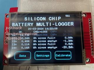

Hello to everyone, I am new to the group but have a problem with a project I am unsure of how to solve.
I recently built the SC project "Battery multi logger".
Its based on micromite type design using PIC32MX170, it uses AD7192 four channel 24 bit ADC with SPI interface. A pic 16F1455 also provide USB to serial interface.

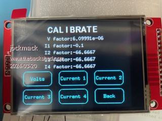

The problem is it works but I am unable to calibrate the current settings for the inputs. I have included some photos to show the interface on the LCD touchscreen ILI9341.
I was able to calibrate the volts OK and it is working fine but when trying to save any of the current values it appears to lock up the display. I don't believe the PIC is locked up as when the display is frozen I can still access the PIC and interrogate it via the USB  port and Tera term. Only a power cycle will clear the display.
I have reloaded the hex image as per Silicon Chip download but the behaviour was the same.

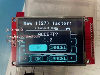

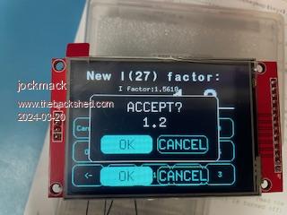

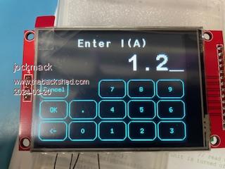

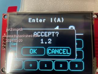

The images are in sequence, when you accept the value entered another OK Cancel buttons are displayed below the original OK Cancel buttons.Selecting OK locks up but Cancel will take you back to the calibration selection display.

Interestingly in the last 2 images in the original post, the heading at the top of the screen says: "New I(27) Factor:". It seems it has already got 27 as the index into I at the time this screen is displayed!
