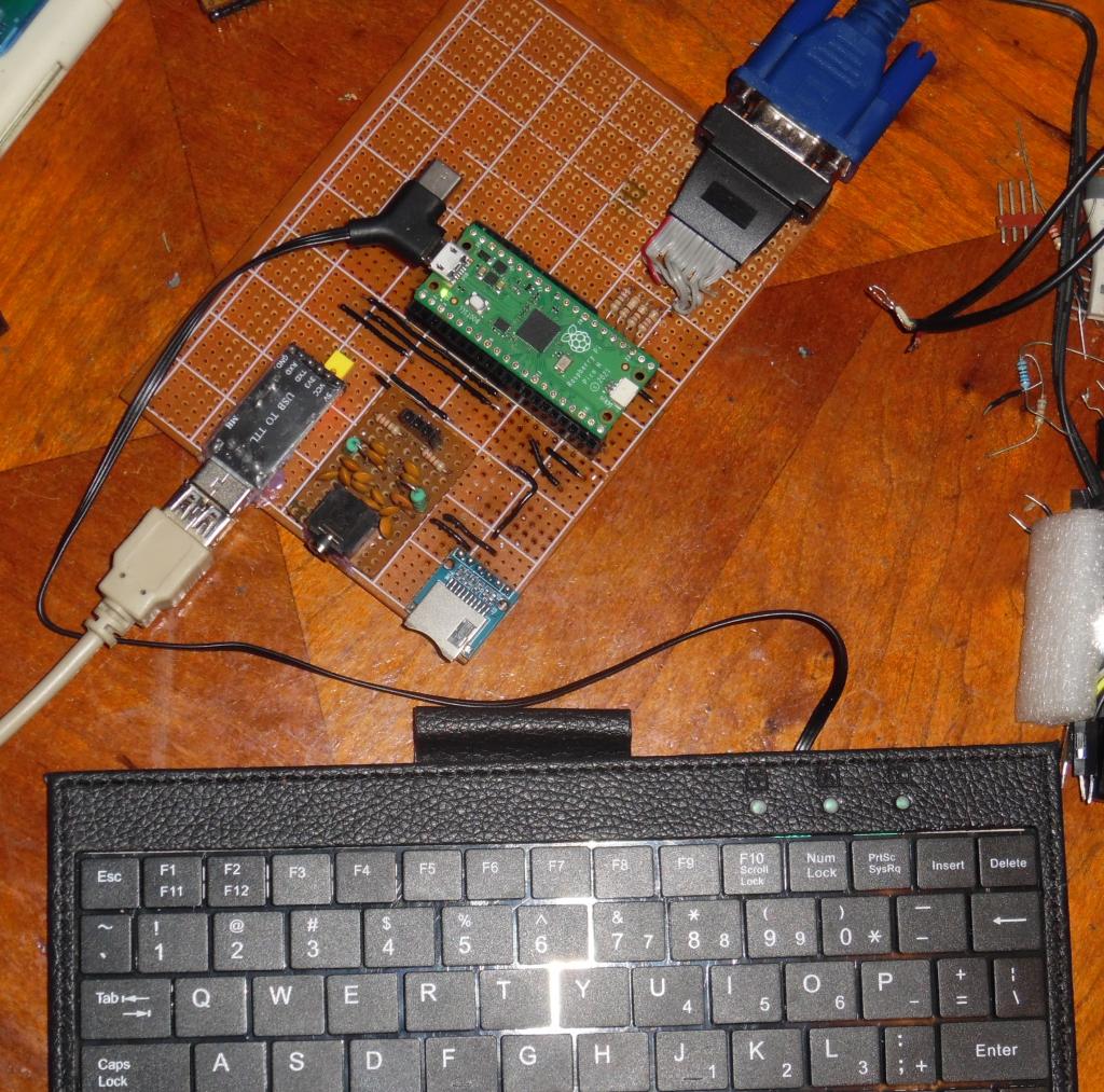

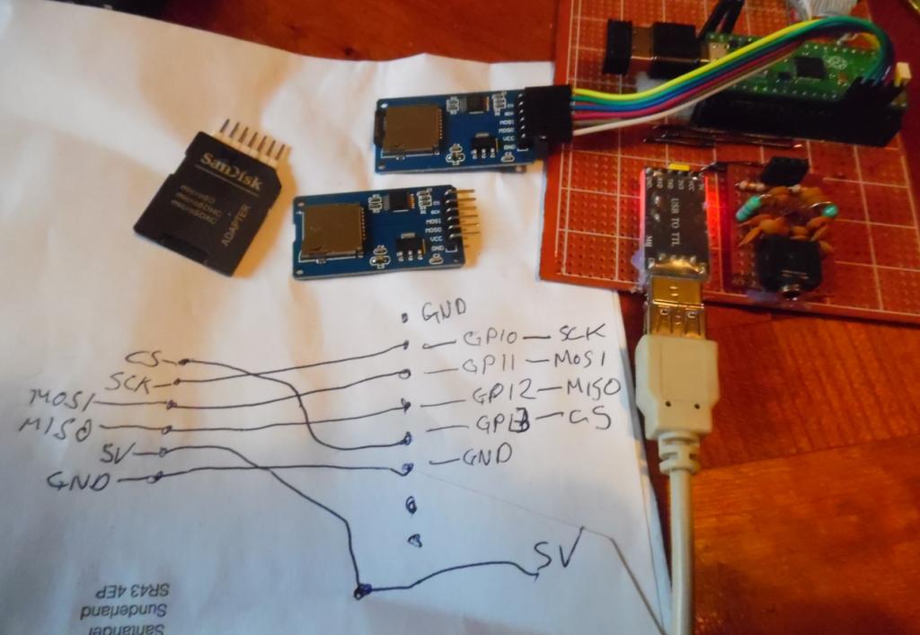

Really sorry to ask but I converted a sd card adapter to a breadboard reader and read sd card but then said "sd card removed" so bought 2 sd card readers , for arduino but logic is 3.3V, 2 for £4.80 but drive "b:" then files says no sd card.
Wiring ok. tried swapping miso/miso.. says moso on reader.
dunno if I contact seller as they may be fine.
using vga usb 005b.
PicoMiteVGA MMBasic USB Edition  5.09.00b5
OPTION AUTORUN  ON
OPTION COLOURCODE ON
OPTION KEYBOARD US
OPTION CPUSPEED (KHz) 252000
OPTION SDCARD GP13, GP10, GP11, GP12

I tried 2 sd cards. one 2 wav files the other a bmp. they read with the soldered sd card adaptor for a minute then said sd card removed. on the forum "they are iffy".
all the ili displays I own have sd card readers that work.
actually thinking I never use sd cards so why bother and use the pins for summat else.
I tried adding a 10uf to the sd card adapter supply but still got sd card removed. even a squirt of wd40 to clean same:)

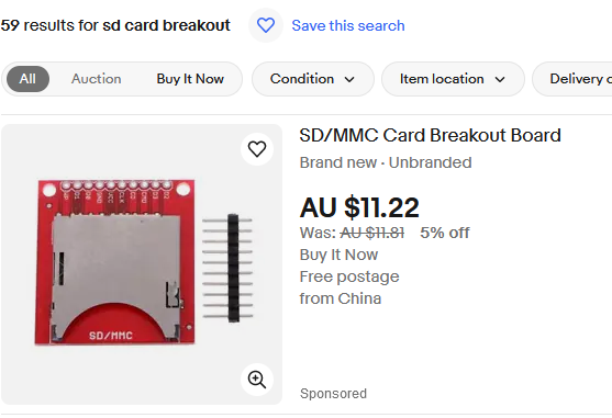

search ebay for "sd card breakout"
I ended up with a page of suitable boards with NO extra chips, just as Peter suggested.

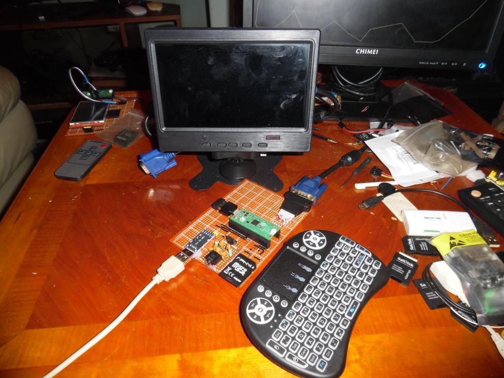

arrived today and works vga usb . thanks Mik
Posted: 08:34pm 28 Mar 2024
it's small. messed up the board with arduino sd reader, tracks cut and wiring then unsolder it all but this was ok but wiring not neat, worked first time though and so cheap I got 2.
