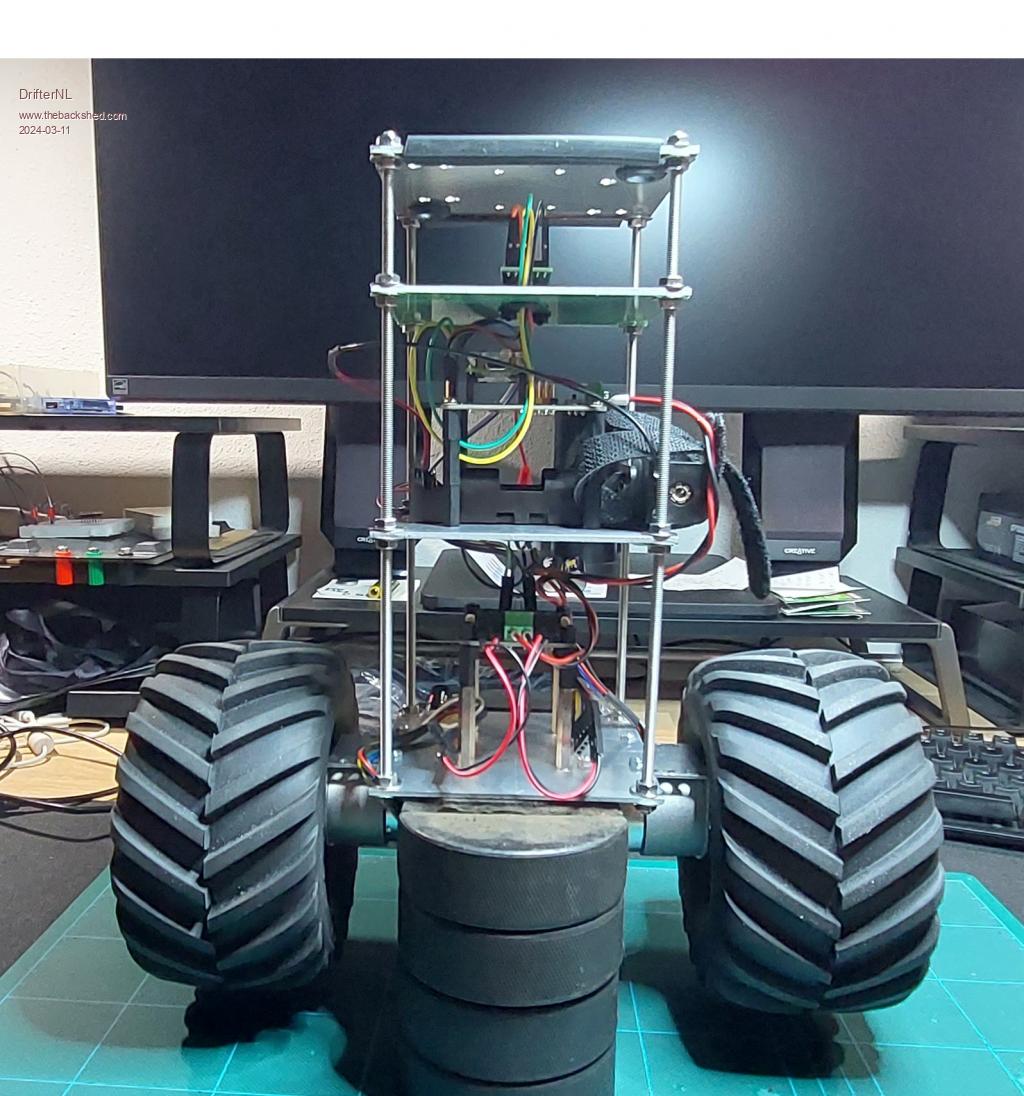

Big Wheel Balancer V1:
I decided to use 100mm x 100mm x 2mm aluminum sheets as the base to mount motors, electronics etcetera and 4mm threaded rod to build up the frame.
The motors I wanted to use were constant turn r/c servos with pololu wheels.
After a few tests I realized that this setup wasn't going to work.
The servos took too long to rev up and didn't have enough speed.
Sorry, no pictures.

Big Wheel Balancer V2:
Controller: Pi Pico with MMBasic
Sensor CMPS12 (later changed to CMPS14) from Devantech (robot-electronics)
Motor Driver: Cytron MDD3A
Motors: Pololu #1445 (later changed to #4752)
Power: 2 (later 3) Soshine 3000 mAh Li-ion cells in series.
Monster Wheels from Amazon with 12mm hex to 6mm shaft adaptors.

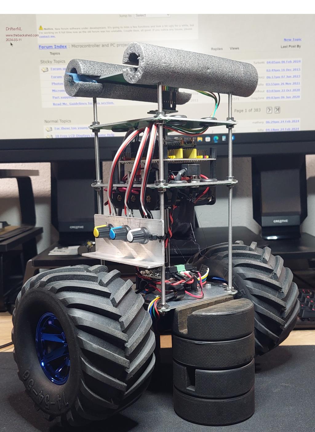

Big Wheel Balancer V3:
Sensor: CMPS14 from Devantech (robot-electronics)
Motors: Pololu #4752
Power: 3 Soshine 3000mAh Li-ion cells in series.
Changes:
Created a new power and controller section and cleaned up a lot of the wiring.
Also added 3 potentiometers to easily-er adjust the PID control.

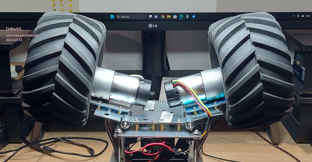

DrifterNL
Joined: 27/09/2018
Posts: 58
Posted: 02:27am 11 Mar 2024
Big Wheel Balancer V4:
I'm working on a few upgrades and will post pictures soon.
This is an ongoing project and I have a few things I want to try / add in the future.
I'll talk about the software challenge and what I learned in another post as well.

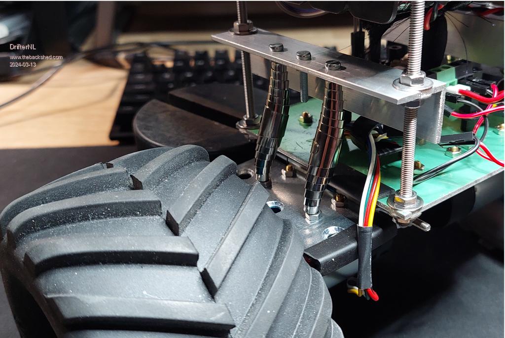

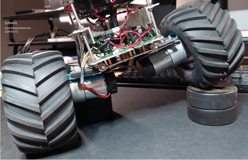

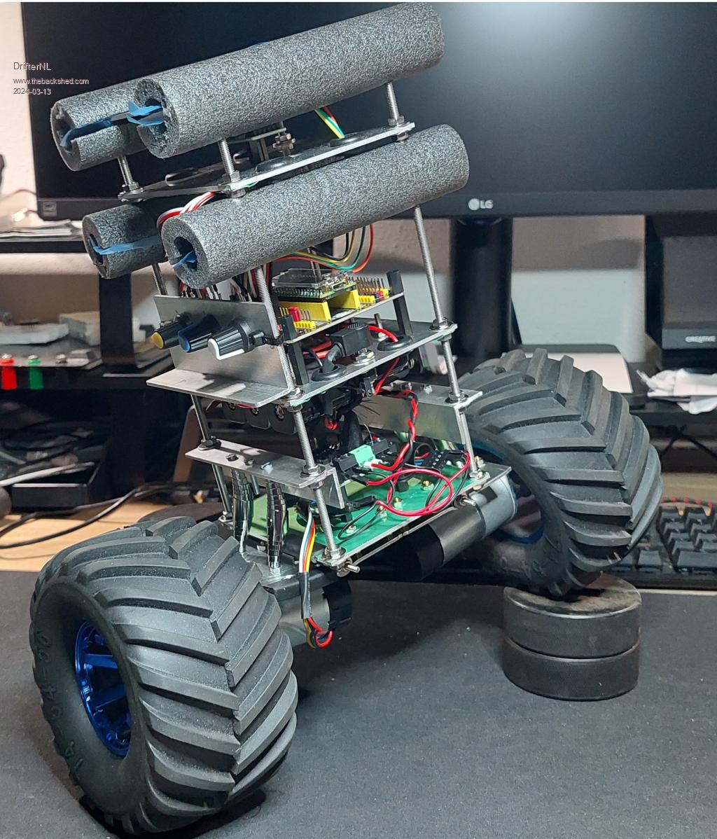

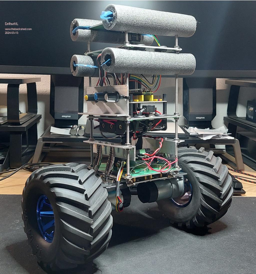

DrifterNL
Joined: 27/09/2018
Posts: 58
Posted: 12:47am 13 Mar 2024
Changes:
Added suspension to the bot.
The suspension is made from 2 door hinges with the pins replaced with brass tube to take out a lot of the slop, metal pcb standoffs and springs that are normally used in garden tools.
Floating Point Keeps Sinking Me!
Back To Integer So I Don't Get Injured.
PhenixRising
Joined: 07/11/2023
Posts: 2104
Posted: 07:29am 13 Mar 2024
Hinges...Brilliant
