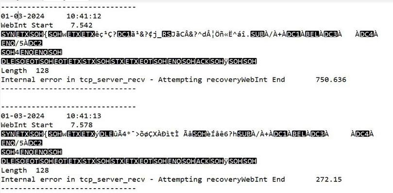

In general, everything seemed to work ok, but I was getting a lot of Watchdog timeouts, plus even more of the:
 "Internal error in tcp_server_recv - Attempting recovery" errors...
which was mostly recoverable...
Process of elimination, I pinned the faults down to this sort of traffic coming down the network (with the gibberish ASCII characters that made no sense to me)
(This is just a sample of the web traffic I've logged, there's many more similar)
The ONLY thing that made sense to me is that the 'Mite receives web traffic, processes it (in this case, would send out a 404 code), but the originator of the request is no longer on line (A bot maybe?) and so a jamb-up occurs and fires the watchdog.
Not being great with web 'hand-shaking', I'm only guessing what it could be...

Now, ONLY web traffic with the WebMite address is accepted and processed - anything else closes the connection.
So far, so good... It's been running for 36 hours without any hiccups, even with the massive amounts of dribble that comes through and gets processed.
First question: is this a normal amount and normal string format that comes through a WWW connection?
Second: Is my coding bad in that I filter the web request that only have the 'Mite IP Address in it and take action on that?

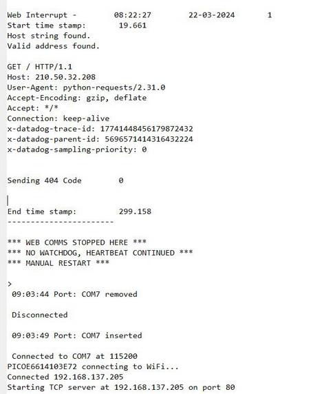

I also added a useless web page to test the functionality on that side of it.
The new code now accepts ONLY the correct Mite address, and/or anything that comes from my ISP.
So far, seems to be working good, but I'll get into work next week and try to access the web page from the CNC computer and give it a solid test.
I'll keep you posted

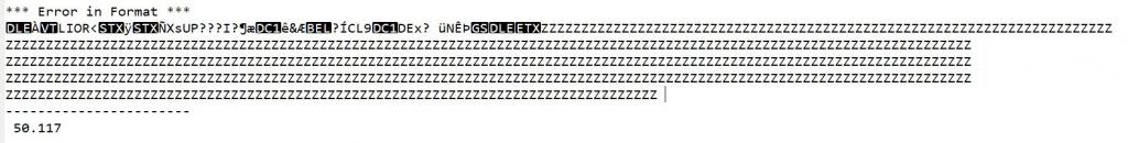

Oh, and just for a giggle, this is my favorite gibberish traffic I've logged...
Really?
What does that even mean!!?
Posts: 6631
Posted: 06:31am 07 Mar 2024
The only traffic that should be able to get to you from the WWW are packets that have been port forwarded.
Broadcasts packets shouldn't be forwarded. That is why I suspect that they might be locally generated.
What ports have you forwarded to the webmite?
If you can save the suss packets to file instead of just printing them, it would be easier for me (and others) to examine them and possibly work out the source.
It is not easy to retype the screendumps as images.

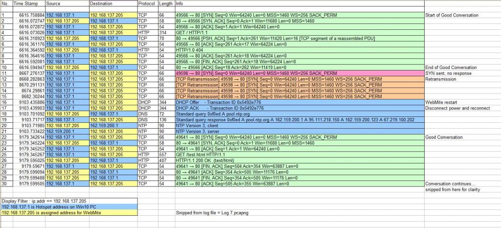

I've been looking a bit more into my problem because every now and then I still get a watchdog timeout after a web hit (There seems to be no pattern to the timing, nor patterns in the web hit 'language', even seemingly good web requests)
I've tried to monitor with WireShark, but as a first time user of it, I can't seem to set it up properly.
My basic networking is:
 Local IP range is 192.168.0.XXX
 Router is 192.168.0.1
 WebMite is 192.168.0.114 (Forwarded from the router)
 My desktop PC is 192.168.0.107
 My public IP is 210.50.XX.XX
So, WireShark picks up all traffic from my local PC no matter if I enter WebMite address, or access via the public IP, and I get the test webpage back as expected.
If I try to get the webpage from my phone, yes, the webpage loads onto the phone, but there's no capture in WireShark.
Setting a display filter to HTTP, or tcp/udp:80 port, it's always my desktop PC address that is listed, so I can't find what traffic is happening with the WebMite unless it comes from my desktop PC... Very frustrating!
Any WireShark experts have a clue where I'm going wrong?
Posts: 6631
Posted: 01:43am 17 Mar 2024
Apart from broadcast traffic, packets go to the destination device and other devices (your PC) can't see them.
Your router 'might' be able to capture data which is either saved to the router memory for later retrieval or forwarded to another device such as your PC.
Some have the ability but hide it from casual users.
One other alternative is (yet to be tested).
If your PC is wired rather than wireless, set up the PC as a mobile hotspot and connect the WEBmite to the hotspot.
That way the traffic to and from the WEBmite is going via your Ethernet port which WireShark can capture.
I also have a managed switch which can echo traffic on on port to another port. If I am desperate that is the way I go but it needs an access point for the WEBmite so the managed switch is between the router and the access point.
I have been monitoring the WEBmite with your sub, hoping for an interesting packet to appear but no luck so far. My Internet must be cleaner than yours!

Here's the latest of my investigations for my problem (It's been a while but I've been a bit bust lately)
Here's the only part of the WireShark logs that I can guarantee is the 'fault', because I was watching the WS screen scrolling at the exact time - so I know I got a good capture.
This is a screen grab from an Excel file of the log, because I could highlight various parts of it to (hopefully) make a little more sense to me...
Down to line 10, it was a good conversation.
On line 11, a SYN was sent, but not answered - so it seems the handshaking was never completed (SYN : SYN,ACK : ACK), with 4 more tried attempts before I manually removed power and restarted.
Here's the console print to MMCC at that moment
Interestingly, the WMite watchdog didn't fire and the heartbeat continued to flash. For some reason, that seems to be the usual case running from a Hot Spot (that's what I've noticed, anyway)
I'm still at a loss to why it's happening - it 'seems' the WebMite is missing the interrupt and I thought this morning that maybe the 1-second timer tick is being served when a web interrupt arrives. Is that possible?
