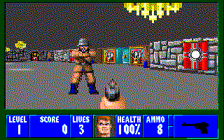

1 1/2 years ago I also started a
Raycasting proof of concept from the same source (yt video from 3dsage)
I found that 2 casts per column (for horizontal and vertical tests) naturally take twice as much time but I hadn't found anything on how to compress this into one single cast
however, i don't think we can create a kind of wolfenstein 3D with it in Basic
Martin

  homa said  Yes, the speed is a problem. But I think if we could solve that, the even bigger problem would be the lack of colour. That's just not enough.
It would be great if you could find ways to increase the speed..
The number of colors is really not high. Nevertheless, I tried to get the most out of the RGB 121, for example, the graphics for Petsciirobots or for my new Alien Syndrome project. So I'm not worried about that. With clever hatching and dithering, you can achieve an appealing result even with the 16 Pico colors.

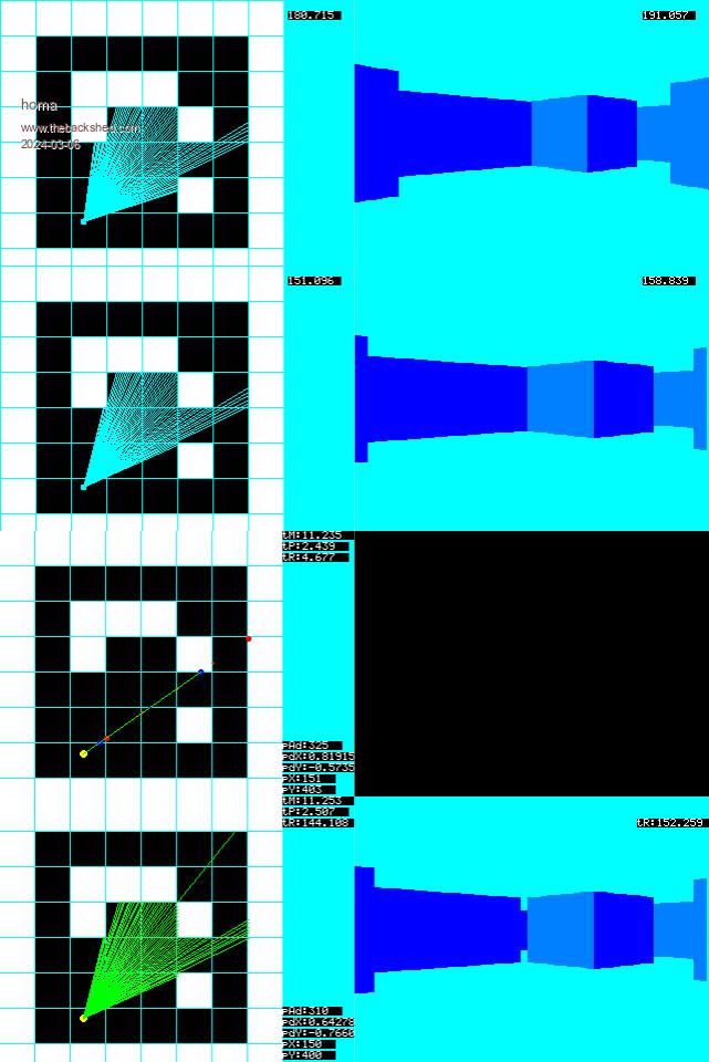

Then I did a rebuild down from my memory for speed reasons. This resulted in the version with the visualisation. Here you can see which vertical and horizontal lines are hit by the visualisation beam.
@martin: You have to check whether the horizontal or vertical ends first ... but it takes place in one loop.
A very small tweak compared to the first version. But the throw of the first version was quite okay! The rest of the optimisation doesn't help.
However, I have encountered new problems with the optimisations. See the pictures.
