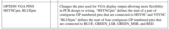

I believe Peter has made the VGA output pins configurable. Not sure where to find it at the moment.
Turbo46
Joined: 24/12/2017
Posts: 1694
Posted: 05:55am 02 Mar 2024
From the manual:
Don't know if it affects that board though.

It looks like they have changed. I guess you need the latest firmware from Geoff's site and use the OPTIONS VGA PINS setting to match.

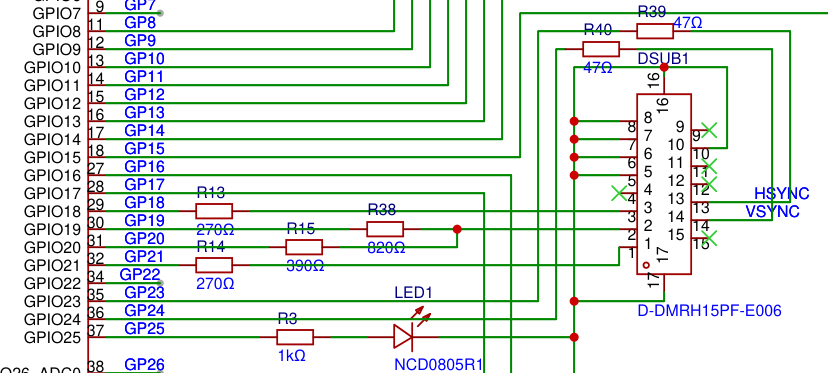

   if you lift R39 and R40 you can probably wire them across to the standard pins available on the 40-pin connector. then disconnect the audio and wire that to the standard audio pins - are there standard pins for audio?
rob   :-)
Footnote added 2024-03-02 18:03 by robert.rozee
remove R34 and R35 to reroute the audio. schematic is here:
https://github.com/UKTailwind/PicoMiteVGAUSB/blob/main/Schematic.pdf

GDay Grogster, All,
On Peter's new PCB he has used GPIO that is not normally available on the Pico.
He used GP23 & GP24 for Hsync and Vsync, neither is available on a standard Pico.
Peter has released different version Firmware for his board. Off hand, I am not sure where to find the latest version for those boards.
Using the standard firmware you need to set the pins used for the VGA pins.
Look up OPTION VGA PINS HSYNCpin, BLUEpin
I believe the correct option would be
OPTION VGA PINS GP23, GP18
