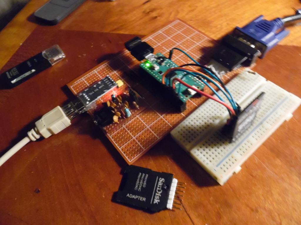

there were threads about sd card readers and this https://www.thebackshed.com/forum/ViewTopic.php?FID=16&TID=16572
use a sd card adapter. It works!. gonna solder it to the board.happy days,reads many microsd cards,no caps

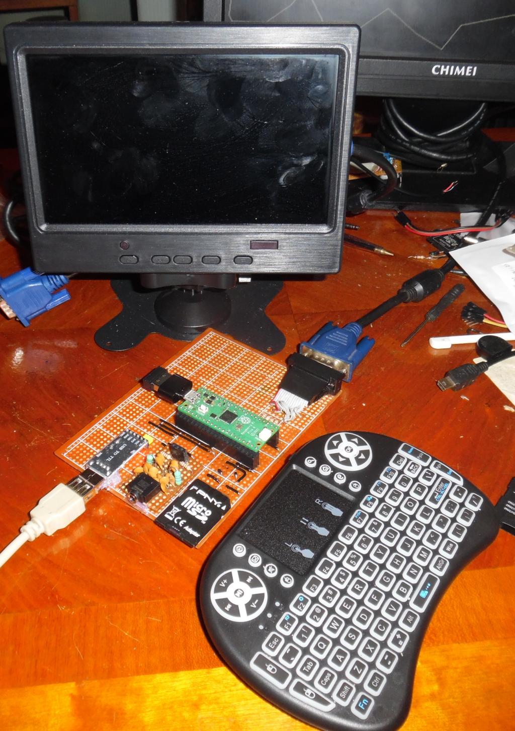

not my idea. I soldered the adapter. A small vga picomite with usb keyboard and 7 inch vga monitor (that works from 5V to 24V)
Posted: 06:30pm 29 Feb 2024
I noticed this after a while
> drive "b:"
> files
B:/
22:39 29-03-2023   55342378  t1.wav
21:11 02-04-2023   65642368  t2.wav
0 directories, 2 files
> Warning: SDcard Removed
added 10uF cap and same. hmmm seemed ok on bread board.
Edited 2024-03-01 06:42 by stanleyella

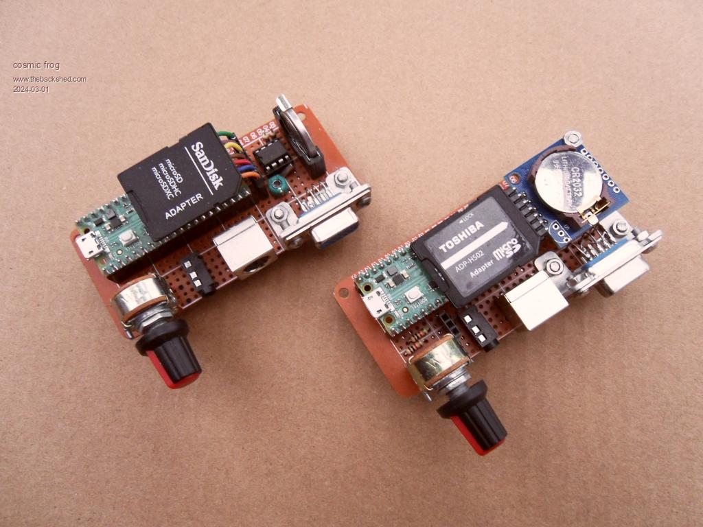

Posted: 08:14am 01 Mar 2024
I also use the SD card adapters and have had a couple not work. Some of them seem to be a bit "flakey"
Dave.
Posted: 02:12pm 01 Mar 2024
neat boards Dave.
I will try lower clock speed, read overclocking is too fast for sd cards
