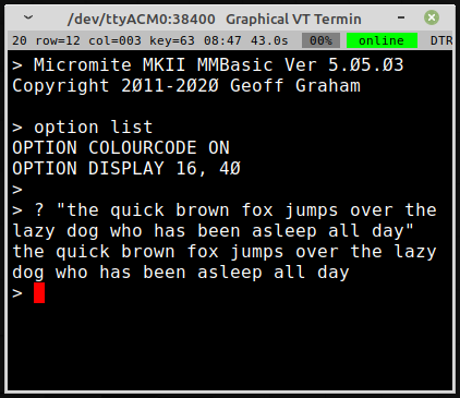

not quite sure what planet you are living on Peter, but the mx170 only supports console mode; all interaction is via a serial console. here is a screen capture:
as you can see, the command line wraps but is still interpreted correctly when the enter key is pressed.
rob   :-)

nope Peter, it is not completely different.
Frank typed in a command (OPTION LCDPANEL CONSOLE 5) that reconfigured the VGA/LCD output to use a font that results in mmbasic thinking that it is talking to a screen that looks to be 21 (13, see below) columns wide by 10 (7, see below) lines high (based upon his screen capture of a TeraTerm window). mmbasic, in error (in my opinion), then decided it would thereafter limit the command line to a maximum length of around 18 characters.
the 18 (11) character (or thereabouts) limit on the command line length prevented Frank from being able to type in anything to recover from the situation. this is, in technical terms, what a reasonable person would consider a BUG.
rob   :-)
