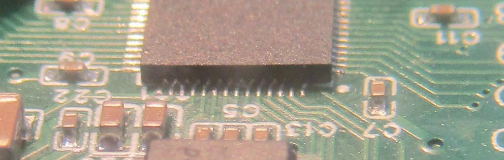

I've finally had a chance to play about with this dud board, and can see that the 2040 chip is mis-aligned on the PCB, and we have bridged pins which is probably why things were getting hot.
Sorry the photo is not the best.  I had to hold the camera at an angle with a magnifying glass to get this shot, but you can still see some bridged pins, and there is actually also at least one pin that is not connected at all.
I will TRY to reflow it, but with the chip being mis-aligned, that could be difficult, cos that actually promotes the bridging of pins when you try to fix it, cos the solder will just want to bridge the pins if the pins are not correctly aligned with the PCB footprint.
But I'll give it a go anyway.
I might have to look into buying a SMD hot-plate, as that would make reworking an entire chip much easier.  I have a crappy air-tool, but I really need a hot-plate and a decent hot air rework station at this point with all the SMD stuff I now play with!
EDIT: Nope, despite trying several times, all I succeeded in doing, was bridging more pins, or not connecting any pins at all.  QFN chips are not really solderable at home!!!  I remember having a hell of a time trying to hand-solder an E28 module prototype that used the 170 chip in QFN footprint.  That was a bugger to do then, and the 2040 pin spacing is even tighter then the 170 QFN, so.....really only for SMD assembly at a factory I think!
