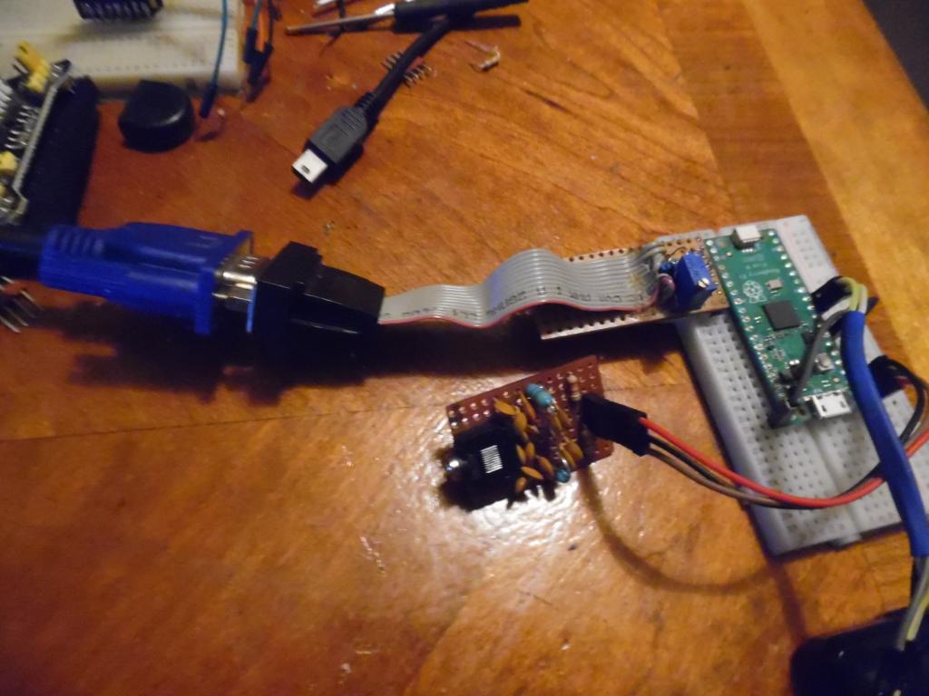

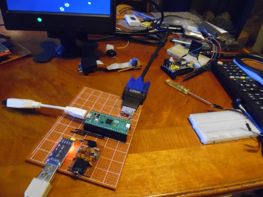

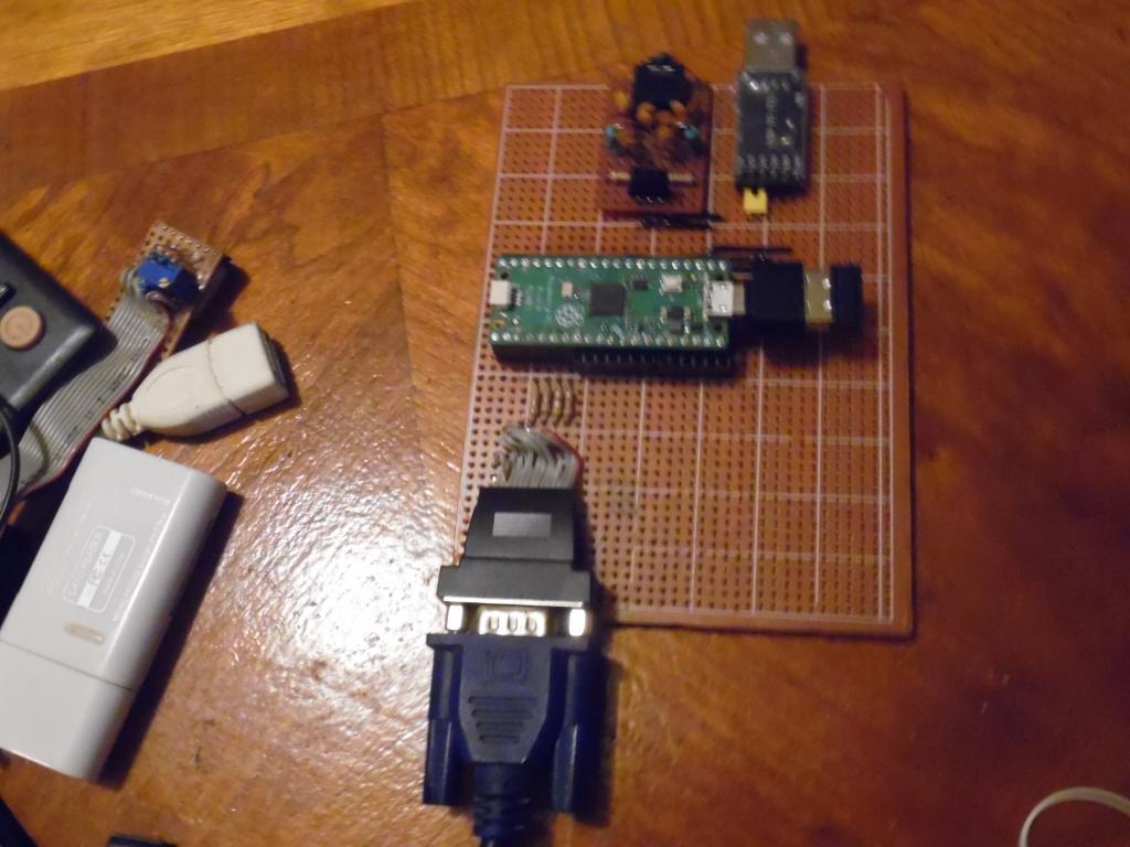

oops. If you want to use vga then you'll find the vga socket is not strip board friendly so any thoughts the pcb designers to make a board to accept vga socket and maybe resistors and 7 pin to plug in picomite board.
you can buy breakout boards but no.
This is faulty but you can see the messy wiring.

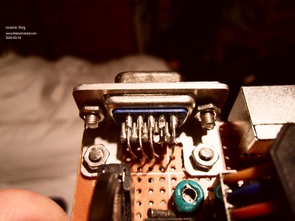

I use a staded chassis mount VGA socket and make a bracket out of angle aluminium.

Ask if this would be useful, using vga needs a socket, how do people use one?
strip old graphics cards for wired vga?
something to replace this mess

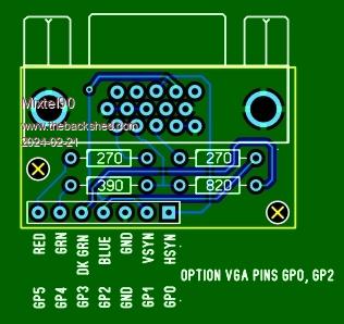

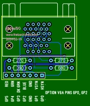

Any use?
Takes two alternative VGA sockets.
New version already. :)
Plugs straight into the breadboard by the Pico.

  cosmic frog said  I use a staded chassis mount VGA socket and make a bracket out of angle aluminium.
/QUOTE]
I was going to use right angle plastic and a dremel and wires a la yours

The pads are for two different VGA sockets. Many of them are the larger size, but some people might have the compact size available. I prefer that one but it's not easy to find in the UK and I had to get some from China. You can't install both at once. :)
My personal preference would be for the second version with the compact socket. It's less to have overhanging the breadboard and there are no wires needed at all.
Another possibility is to include GP8 and GP9 on the same board, together with a USB-C to TTL adapter, which could also power the breadboard at 5V (or even 3V3 if you limit it to less than 100mA). :)

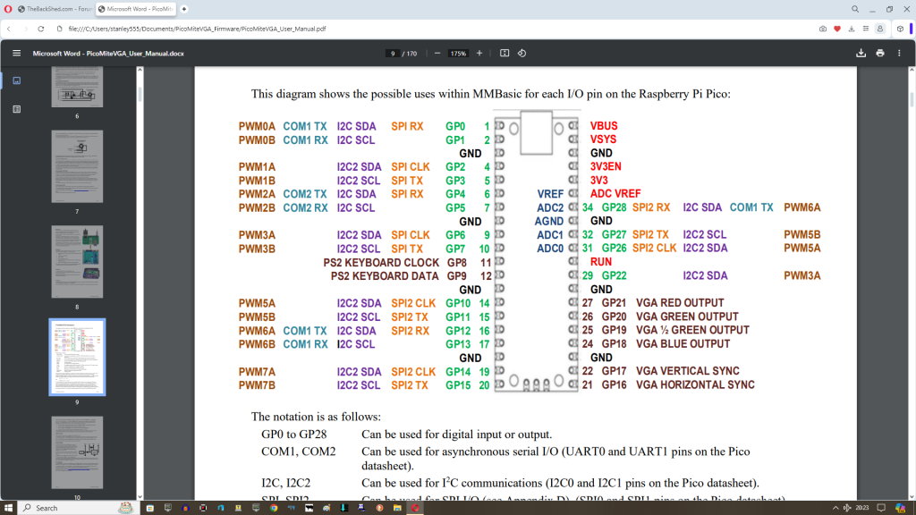

Hi Mick, in the manual 1/2 green is 820R, you use 680R. there about is ok?

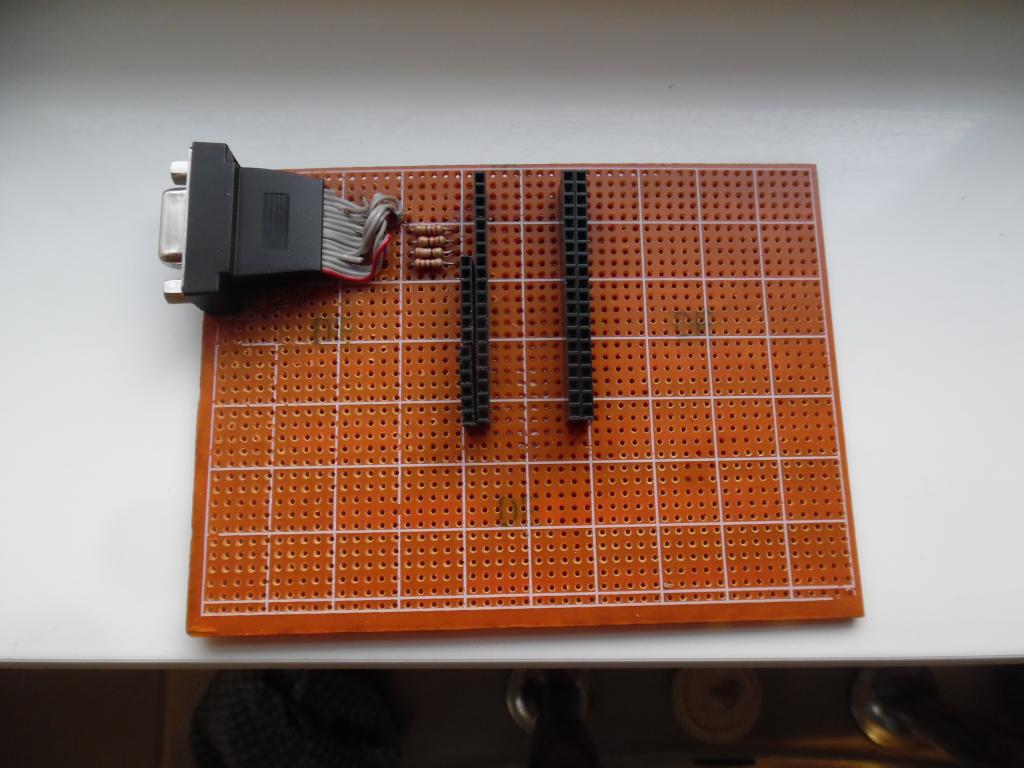

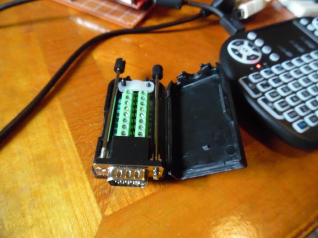

I bought a vga breakout plug but could have just cut a vga lead and soldered the end to the board.
Posts: 9246
Posted: 04:48pm 19 Feb 2024
Nothing is critical. 820R is correct and my brain isn't.

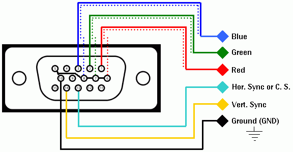

Mick, I use "vero" and poo poo it for high freq capacitance or whatever. it's handy and not that bad really in reality if you want to solder a bit more permanent than strip board test. vga is one of those that are not vero pin friendly but do the ground got to be connected? otherwise not many leads to bend into 8 holes/strips.
sorry. you are a pcb guy

For short VGA leads a single ground wire works ok.
For very long leads a separate ground for each colour is needed as they are co-axial, and one for sync. Some have another ground for the data signal (not used on the Pico).

phil99, one ground not join the vga plug grounds. bend the other pins to vero maybe?
18"vga lead would be fine

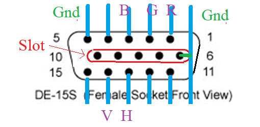

My PicoMiteVGA is also on strip board. As the Pico only uses the centre (offset) row for ground I used a Dremel to cut a slot in the board for those pins. The last pin of the centre row (the one that sticks out from the other two rows) is then bent a little to solder to the adjacent track.
Viewed from the top side. Reverse for the track-side view.
You could also make the slot by drilling out the centre row of holes to a larger size then tilt the drill left and right to join the holes.

It's everyone wants a solution. boards on ebay. it's getting all the bits and a pcb is permanent. I only wanted one vga picomite for now and the vga wiring I thought fault just needed the securing bolts on the vga screwed or bad connection.
I bent the pins on the usb to ttl and mounted it upside down and soldered the audio filter. bit nore solid than strip board.

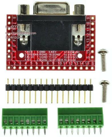

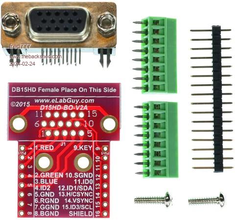

Posted: 06:34pm 20 Feb 2024
Hi Mick. I just used vga from old pc cards. If I had a vga socket with right angle leads then you only need 6 pins so cut the excess and bend the others. I'll look up vga socket types and price.
I screwed 2 self tappers through the vero into the vga and used araldite. bodge but solid.
I'll have 5 boards £3.80. tell me how please. regards stan
