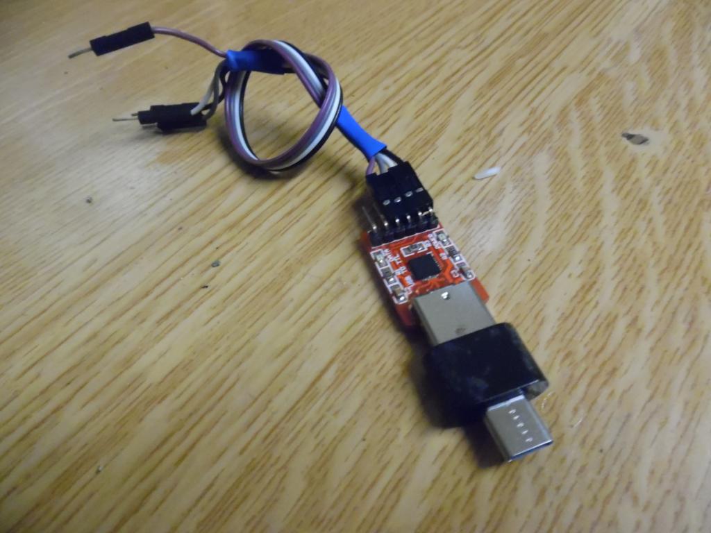

I want to mount the usb to ttl horizontal on strip board. don't think desoldering pins and replacing easy, maybe straighten them and mount upside down or remove the plastic joining the pins and bend them 90deg
Posts: 9246
Posted: 05:15pm 18 Feb 2024
These, Stan.
Posted: 05:41pm 18 Feb 2024
Thanks Mick, more sensible for vero.
