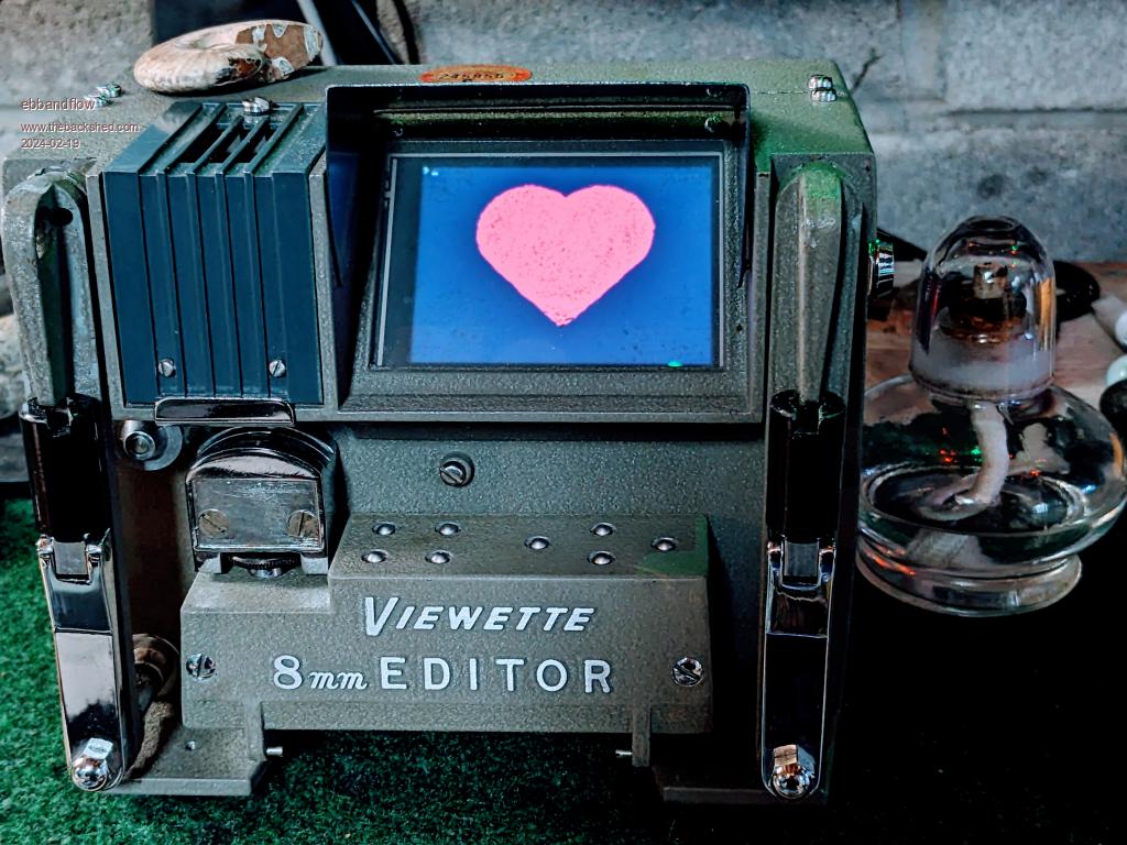

Not a lot to say.
It should run on anything from a geek to cmm2 and MMB4W
 OPTION EXPLICIT
 OPTION DEFAULT INTEGER
 DIM INTEGER frame, c
 DIM FLOAT x, y, p, w = MM.HRES, h = MM.HRES, hw = w/2, hh = h/2,sz, ys = 40
FUNCTION sdHeart(x AS FLOAT,y AS FLOAT) AS FLOAT
 STATIC FLOAT a, b, c
 y = y + 0.5 : y = 1.0 - y : x = ABS(x)
 IF x + y > 1.0 THEN
   sdHeart = SQR((x - 0.25) * (x - 0.25) + (y - 0.75) * (y - 0.75)) - 0.35355
 ELSE
   c = x + y
   IF c < 0 THEN
     c = 0.0
   ENDIF
   a = x * x + (y - 1.0) * (y - 1.0)
   b = (x - 0.5 * c) * (x - 0.5 * c) + (y - 0.5 * c) * (y - 0.5 * c)
   IF a < b THEN
     sdHeart = SQR(a) * SGN(x-y)
   ELSE
     sdHeart = SQR(b) * SGN(x-y)
   ENDIF
 ENDIF
END FUNCTION
 CLS
 FOR frame = 1 TO 250
   FOR c = 1 TO 10
     x = RND()*w
     y = RND()*h
     p = sdHeart((x - hw) / hh, (y - hh) / hh) * hh
     IF p < 0 THEN
       COLOUR RGB(150,20,10)
       sz = 1.5
     ELSE
       COLOUR RGB(20,20,70)
       sz = 1.5
     ENDIF
     p = ABS(p)
     CIRCLE x,y-ys,p
   NEXT c
   PAUSE 100
 NEXT frame
It needs the pause to see whats happening.
Translated form PureBasic which was translated from  https://www.shadertoy.com/view/dljyDc

Line 6 includes "h = MM.HRES". Is that as intended? It works fine regardless.
Posts: 6631
Posted: 09:23pm 18 Feb 2024
  vegipete said  Line 6 includes "h = MM.HRES". Is that as intended? It works fine regardless.
That was the deliberate typo to see if anyone was looking.
Either that or I should proofread my work better.
As you probably assumed it should be MM.Vres and if you correct that, you will need to change the end of the line to ys = 0
 Dim Float x, y, p, w = Mm.hres, h = Mm.vres, hw = w/2, hh = h/2,sz, ys = 0
ys was added to make it fit the geek but correcting h was the correct fix.
