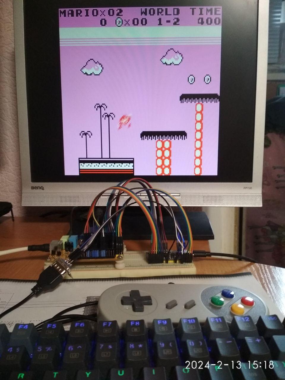

Adapted the pico-gameboy firmware of the GameBoy emulator for the PicoMiteVGA board
https://github.com/xrip/pico-gameboy
On the SD card, create a folder GB: in the root, put the ROM (*.gb *.gbc) files there.
Controls:  PS/2 Keyboard & NES Gamepad
UP, DOWN, LEFT, RIGHT - Arrow keys
A Button - Z key
B Button - X key
START - Enter key
SELECT - Backspace key
SELECT+START in game menu
The NES gamepad is connected like the PicoGAME VGA board
        NES_GPIO_CLK=  GP3
        NES_GPIO_LAT=  GP2
        NES_GPIO_DATA= GP1
Gamepad power supply is 3.3 V
Mono Audio on GP22

Unfortunately, I don’t have the PicoMite board itself and I ported it on a breadboard assembly (photo at the beginning)

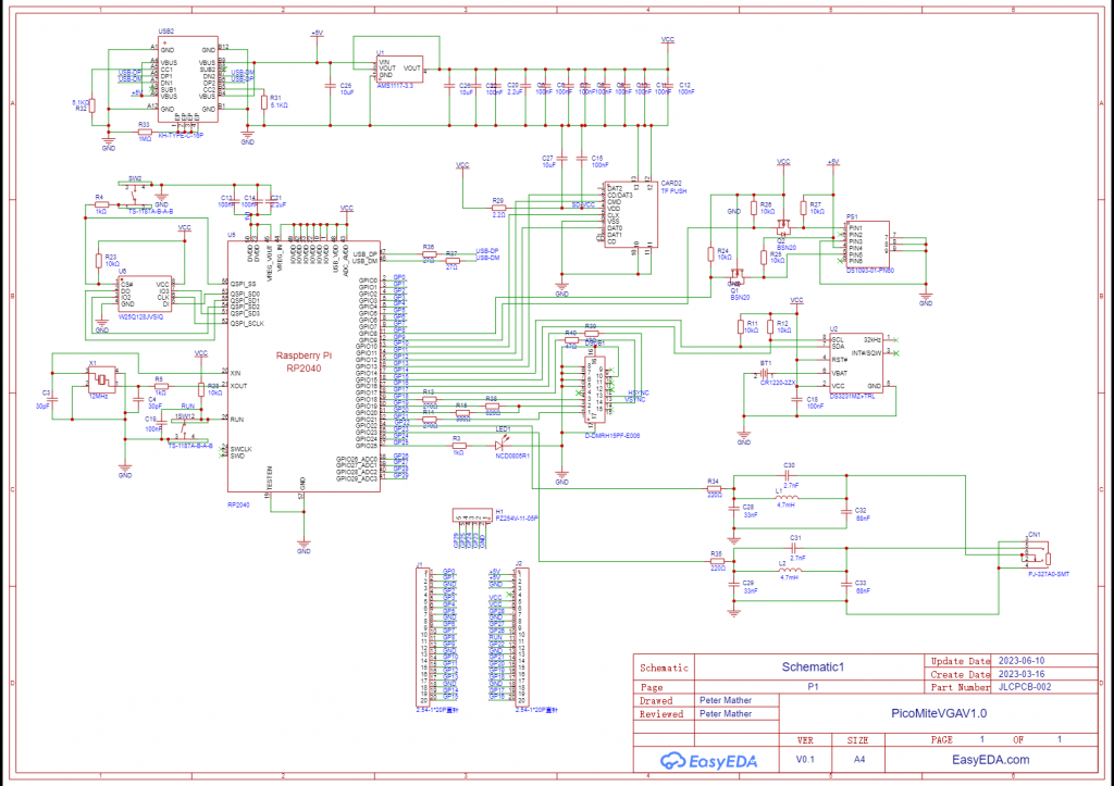

Hi, it's just a PicoMiteVGA. It's built on a piece of proto board. I wasn't aware there was a special board.
Is there a schematic for this board so I could build it myself?
Thanks.
Dave.
javavi
Joined: 01/10/2023
Location: Ukraine
Posts: 597
Posted: 05:47pm 14 Feb 2024
PicoMiteVGA10_scheme.pdf

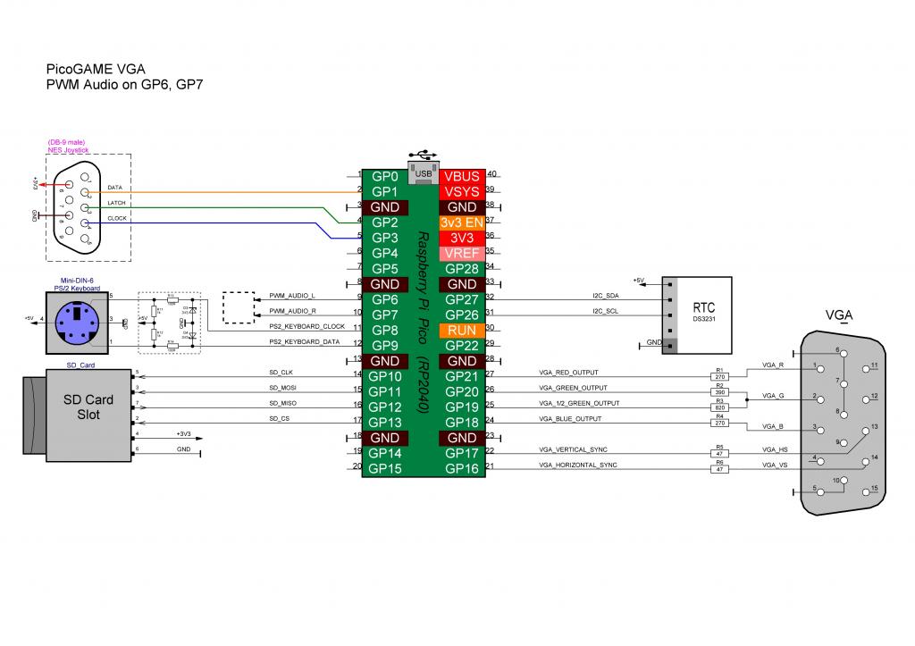

PicoGAME VGA
https://github.com/thwill1000/pico-game-vga
PicoGAME VGA_14A Circuit.pdf
cosmic frog
Joined: 09/02/2012
Posts: 310
Posted: 08:42pm 14 Feb 2024
Just looked at the schematics and the wiring is the same on my board, only the sound is wired to GP0 and GP1 so my board should work ok just without sound.
I will have to have another try.
Posts: 9081
Posted: 09:16pm 14 Feb 2024
I sort of recognise that board. :)

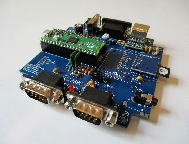

PicoGAME has GP0, GP1, GP2 and GP3 on Port A for the joystick/controller connections.
Edited 2024-02-15 07:17 by Mixtel90
javavi
Joined: 01/10/2023
Location: Ukraine
Posts: 597
Posted: 04:06am 15 Feb 2024
  Mixtel90 said  I sort of recognise that board. :)
Hi Mick,
I did an assembly for PicoGAME VGA using a NES gamepad connected to Port A, which uses GPIO ports for its operation: GP1, GP2, GP3
PWM sound on ports GP6, GP7
If you or anyone else needs it, I can change the connection as you please.
And, although the RTS is shown in this diagram, it is not used for the GameBoy emulator.
Best regards to everyone,
Java

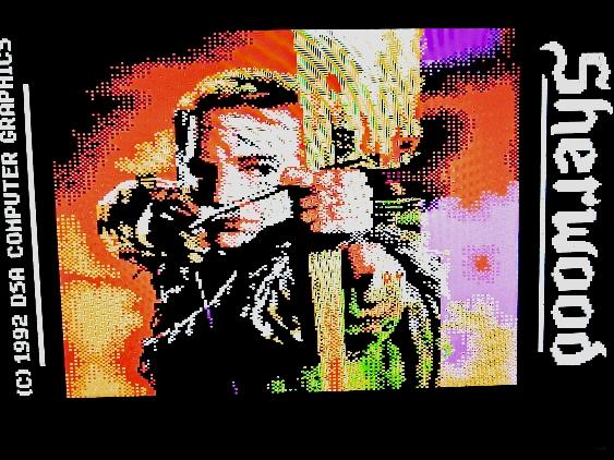

Yes, this could be done, for example Sinclair Spectrum 48k and 128k!
But there is one point, I don’t know how to convey the Spectrum color palette (8 colors with two brightness levels) using the PicoMite VGA121 scheme!??
javavi
Joined: 01/10/2023
Location: Ukraine
Posts: 597
Posted: 11:30am 15 Feb 2024
Yes, I understand from the PicoGameVGA scheme that on port A to connect the NES joystick, pins 2,3,4 are used corresponding to the GPIO ports GP1, GP2, GP3
Martin H.
Joined: 04/06/2022
Posts: 1519
Posted: 01:43pm 15 Feb 2024
  javavi said
  cosmic frog said
Would you be able to convert other consoles as well as the Gameboy on this platform?
could be done , only missing Color is Bright White
Spectrum Colors
Scolors:
'Normal 8 Colors
Data 0,255,16711680,16711935,32768,33023,16744448,16777215
'With Bright
Data 0,16639,16728064,16728319,65280,65535,16776960,16777215
Normal 8 Colors
R  G  B
00 00 00 BLACK
00 00 FF BLUE
FF 00 00 RED
FF 00 FF MAGENTA
00 80 00 Green
00 80 FF Cyan
FF 80 00 Yellow
FF FF FF WHITE
With Bright on
R  G  B
00 00 00 BLACK
00 40 FF Light BLUE
FF 40 00 Light RED
FF 40 FF Light MAGENTA
00 FF 00 Light Green
00 FF FF Light Cyan
FF FF 00 Light Yellow
FF FF FF WHITE
see :
Open SCR file (ZX Spectrum standard screen)
Edited 2024-02-15 23:44 by Martin H.
'no comment
