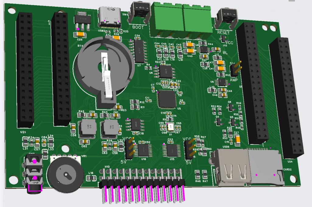

Existing PCB designs for LCDs all suffer from the slow speed of transfer to the screen so I thought can I get the Pico to support a full 16-bit parallel RGB565 I/F and still make it useful?
The answer was NO
However, I could get it to support RGB555 and that one pin makes the difference. With the new USB support for Keyboard, mouse and game controllers the allocation of every single pin on the RP2040 is not the issue it would have been previously.
Here is the design:
3e2a4967-01dd-411f-8f0d-87a8da272427.pdf
The intention is that this design can, if you wish, be used completely standalone with the LCD acting as the console device and, of course, a USB keyboard for input.
Pins GP0 to GP15 are the data pins for the LCD except that GP5 (least significant bit of green) is not connected and G0 on the LCD is connected to G1
GP16, GP17, and GP18 are the control lines for the LCD. The reset line is connected to the processor reset which in turn is controlled by a proper reset controller chip (TCM809)
GP5 and GP19 are used for the touch I/O (CS and IRQ)
GP20, GP22 and GP23 are SYSTEM SPI
GP21 is the SDcard chip select
GP24 and GP25 are the SYSTEM I2C and control the RTC and a pair of 8-bit port expanders (TCA6408)
that individually can be selected for 3.3 or 5V I/O and connect to a 20-pin card-edge header
GP26 and GP27 are the audio output pins and output via a line level jack and stereo PAM8302 amplifiers
and finally
GP28 and GP29 are the serial console connected to the outside world by a ch340 USB to TTL convertor.
The USB-C connector for the serial console also provides the power.
I've included interfaces for both 34-pin and 40-pin LCDs so that covers:
2 variants of ILI9341
All variants of SSD1963 up to 7" (480x272 and 800x480)
and both types of 4" 800x480 LCD (OTM8009A and NT35510)
The  reason for pairs of both the 34-pin and 40-pin headers is to allow screens of different sizes to be roughly centered, however 1 or both of the duplicates may not survive the layout phase.
Thoughts?
