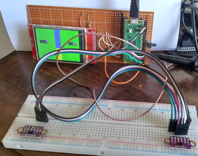

I have been playing with multiple VL53LOX range finder modules.
The following program is intended as a contactless switch - very Covid friendly.
2 modules are connected to the same I2C bus. I used I2C2 but whatever suits.
One module has its XSHUT pin connected to the pico.
To change the address of one of the modules, the one with the XSHUT connected has the pin pulled low to inhibit it .
The other module then gets a new address and the first module released.
We now have two modules with different addresses. This can be expanded as far as you like.
The rangefinders are read every 50mS and then the rest of the code determines if you are swiping left or right. You can also hold a hand close to either module for a simple up/down control. If you want to upset the cat, a pair of tom-toms may be another use.
My initial use will be for a radio control, swiping to change stations and tapping to change volume.
This allows me to control the radio in the shed with oily/grubby fingers or gloves etc.
A video of it in action is on my website
https://www.c-com.com.au/stuff/swipe.mp4

There are lots of PRINT statements which are only for development and can be eliminated.
The I2C scanner is only there to prove the change of address.
pin GP20 is connected to the CRO for timing measurements.
Edited 2024-02-10 17:41 by TassyJim

Have you tested the accuracy/repeatabilty of displacement sensing, Jim?
I have one of these somewhere but didn't get around to playing with it yet.
Posts: 6631
Posted: 07:43pm 10 Feb 2024
  PhenixRising said  Have you tested the accuracy/repeatabilty of displacement sensing, Jim?
Repeatability is good.
I used the modules as is without any calibration so the results are not perfect.
I will play with calibration when time permits but for now, they are reliable enough for this purpose.
When I start putting the sensors behind a window, I am sure that calibration will be needed.
In the program, anything closer than a nominal 50mm is too close and ignored, from 50 to 100 mm is considered a 'tap' and from 100 to 300mm is in the zone for 'swiping'
The true distances are about 20mm closer and I should be subtracting that 20mm from the returned values. I decided to leave the values as reported and adjusted the program to suit.
I did find a few stray readings that upset things and I had to allow for them.
I was concerned that there would be some interaction between the two modules but that doesn't seem to be a problem. It might be with 4 modules in use.
The sensors have a narrow beam and that can be a good thing but also a problem for some uses. They also take about 30mS for a reading so I put them into continuous mode and make use of the most recent results which could be 30mS behind the times. That way it is only 1mS to get both readings.
