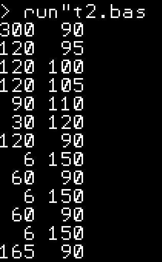

I made some changes to your code
option explicit
option base 0
dim BS20min%(12,1)=(300,120,120,120,90,30,120,6,60,6,60,6,165,  90,95,100,105,110,120,90,150,90,150,90,150,90)
dim x%, y%
for x% = 0 to 12
   for y% = 0 to 1
       print right$(space$(3) + str$(BS20min%(x%, y%)), 3) + " ";
   next y%
   print
next x%
output:
