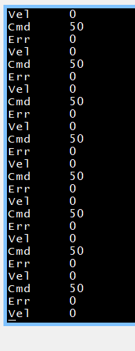

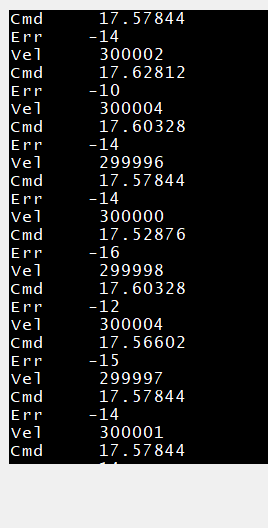

No "Sync" that we have in PicoMite Basic and so I profiled (surprisingly good):
Velocity regulation is amazing, considering the simple H-Bridge:
Command Velocity: 300,000 quad cts/sec = 150 revs/sec (2000 cts/rev) = 9000RPM
Cmd: The PWM%. This is "Antiphase PWM", meaning that 50% duty-cycle is zero output to the motor.
Err: Command_Position - Actual_Position. Velocity Feed-Forward (VFF) applied.
Vel: Actual motor velocity in quadrature counts/sec.
Steady state maintains zero position error. Force the motor shaft out of position or turn it with motor power (32V DC) off and it will jump right back.
