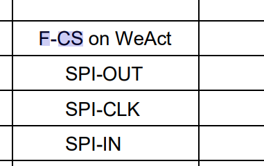

I have a WeAct and just wondering what F-CS is?
Posts: 11785
Posted: 06:02pm 07 Feb 2024
Chip select for a flash chip that may or may-not be fitted

I have not looked to see if F-CS has a pullup, if not you will need to set it high  as the flash is sitting on SPI.
From the H7 manual for WeAct board.
The onboard W25Q16 SPI Flash chip is connected to SPI1 and its F_CS pin is 87 (PD6). It can be accessed
from Basic. Use SPI and set pin 87 as an output and use as the F_CS. See appendix E

  disco4now said  It looks like the gitHub site for the WeAct  H7 100 pin board is gone.
Here is the schematic for it I have previously downloaded.
STM32H7xx SchDoc V11-WeAct100.pdf
Thanks Gerry, I wanna build my own board (doesn't matter which variety) so this could be useful.
Don't know if this belongs in the manual-corrections thread but you have illustrated above, why I had to ask about 'F-CS'. It is shown on the table with a hyphen but naturally, a search of the manual found no explanation because elsewhere it has an underscore 'F_CS'.

  Quote  Don't know if this belongs in the manual-corrections thread but you have illustrated above, why I had to ask about 'F-CS'. It is shown on the table with a hyphen but naturally, a search of the manual found no explanation because elsewhere it has an underscore 'F_CS'.
Now corrected in the source document so will be fixed in the next update.
