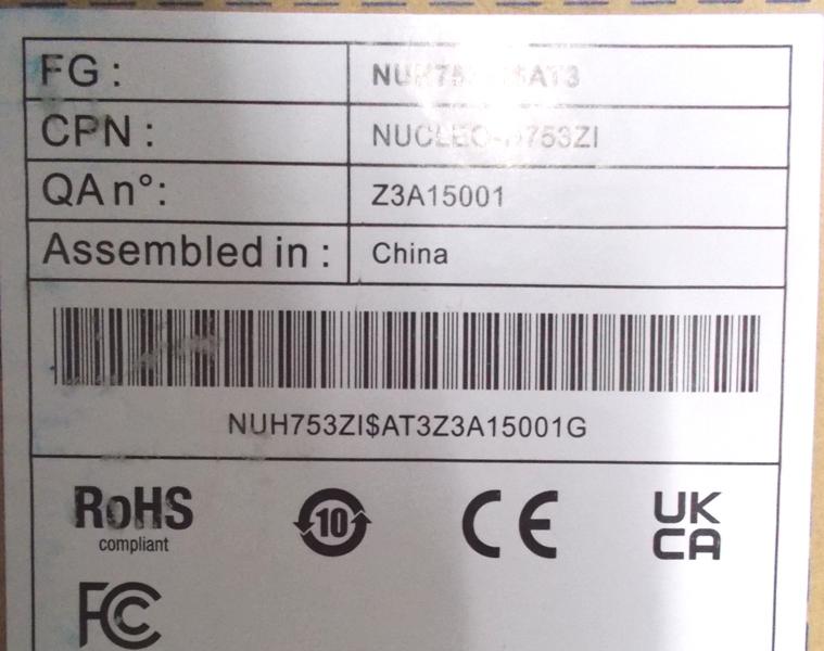

This is from Mouser here in AU.
Mouser
FYI : The Board I have is NUH753ZI$AT3

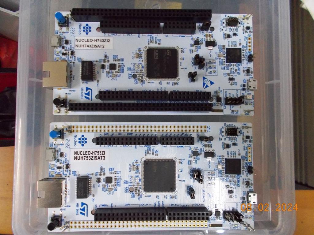

Just had another look at the H753 and H743 boards.
They look identical in every way, every link is the same, both boards have MB1-1364E in the bottom screen overlay. The only difference on the bottom is H74 is replaced by H75.
A lot of outlets still show very little or Zero stock of the H743Z12, whereas the H753ZI numbers are in the hundreds. It would be nice if it was fully compatible.
Uploaded a large photo of an old H743 and newer H753. Just looks like a CPU change.

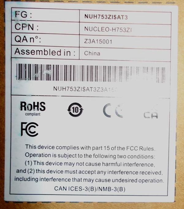

Posted: 10:21pm 13 Feb 2024
Yes, the NUCLEO-H753ZI (NUH753ZI$AT3) are in plentiful supply and are a current product.
This is the board I'm testing.
