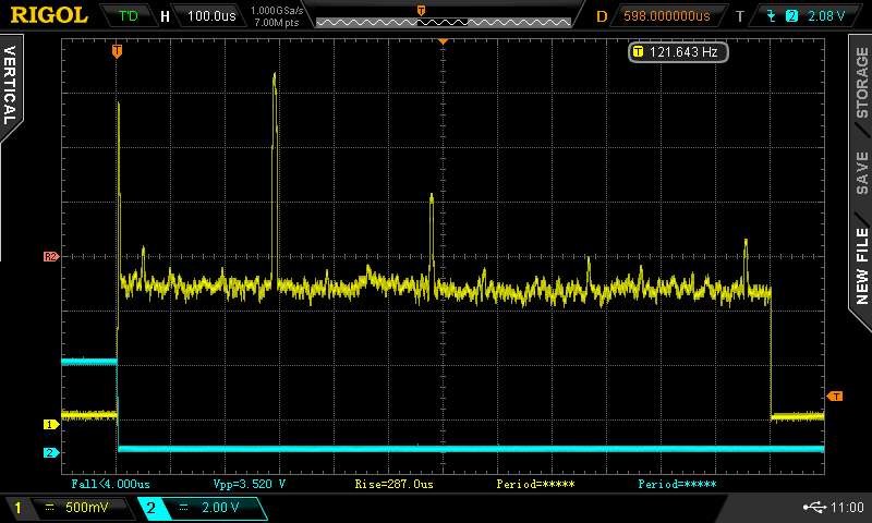

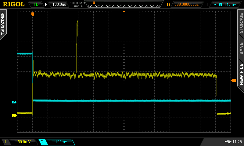

looking at the STM32F407VGT based Black boards, some ALiexpress vendors
offer STM32 chips or GeeHy APM32 chips.
Supposed to be interchangeable.
there are differences.
One thing I have found is the ADC .
I tested it using my FFT code (with options for FFT size, sample rate etc.)
No changes were made to the code loaded into both boards.
I used the Arduino IDE with STM's support package for it.
test condition is
sample rate: 500kHz
sample size: 2048
ADC resolution: 12 bits
Flat top window
time average: 8 traces (smooths out the noise)
20 db/vertical division
1V p/p 60kHz sine
Blue trace is a sync pulse for the DSO trigger
Yellow is the FFT magnitude. 0 to 250kHz over 12 divisions
First is the STM32F407
then the APM32F407
It is clear the APM32 has an inferior ADC design.
The second harmonic of the 60kHz is -42db
The APM chip also has another harmonic at -60db
The STM chip has nothing above the noise level
but this is a few db more than the APM uC
I have tested this at various sample rates from 500Hz to 500kHz
and that 2nd harmonic is always there, no matter the signal frequency.
The aliexpress vendor has the APM board only about $2 cheaper than the
$15 STM based board. There could be more differences in the chip
but this is the first one I found so far.
here is the code I used if anyone is interested. (probs. not)
stm32f4_cmsis_fft_serial_config.zip
