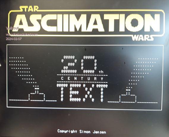

Posts: 6199
Posted: 08:52am 07 Feb 2024
For the PicoMiteVGA users...
Here is the movie player and movie for PicoMiteVGA.
The size will fit on the A: drive of a PicoMiteVGA, but it runs just as well from the SD card.
UNzip, and run "player.bas"
If needed change the variable "fps" to your desired speed.
Have fun.
SW1.zip

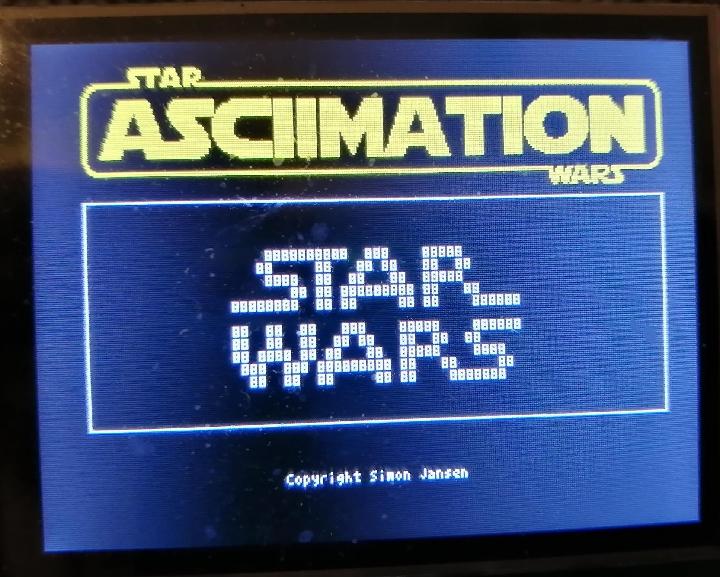

Here is my version adapted for Game*Mite
GameMite.zip
copy both files in the SW1 Folder and start the GM_Player.bas
Edited 2024-02-08 04:38 by Martin H.
'no comment
Posted: 07:05pm 07 Feb 2024
I've seen this before, but it's awesome to have it on the Game*Mite.
