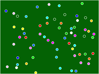

I attach a simple demo program showing a standard PicoMite (or PicoMiteVGA) using all 64 sprites with full collision detection

  matherp said  I attach a simple demo program showing a standard PicoMite (or PicoMiteVGA) using all 64 sprites with full collision detection
Neat, though I'm not sure why the image I saved with "SAVE IMAGE" after exiting has a green background rather than the black one on the ILI9341.
Is it "CLS RGB(myrtle)"? Nearly black, so not transparent?
?hex$(pixel(1,1),6) yields 006000
cls rgb(myrtle) actually looks light green on the screen.
