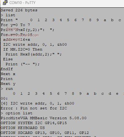

lizby, thanks for the test app.  It appears I have two DS1307 boards that aren't functioning.  I find a ds3231 board is working well, although it's form factor won't work as well as the tiny I2C 1307 boards.  I've ordered two more boards from Amazon and will try again.
Again, thanks for the useful app.  I tried it but it doesn't work
in I2c write line, error : Pin not set for I2C
Edited 2024-02-01 04:46 by dpcons

  dpcons said   useful app.  I tried it but it doesn't work
If you have set OPTION SYSTEM I2C connect the module to the pins specified there (option List) and don't set I2C in the program.
Eg. change the start to this:-

Posted: 05:38pm 02 Feb 2024
Mozzie, you are correct on the I2C2 modification.  App now works.
Thanks much.

Edit to suit then copy & paste the relevant lines to the command line.
> 'SDA pin = GP 4 and SCL pin = GP 5 on channel 1
> setpin gp4,gp5,I2C : I2C open 100,200
> for addr=0 to 127: I2C write addr,0,1,0:If not MM.I2C Then :?addr,"&h"hex$(addr):endif:next
81     &h51
87     &h57
> 'Using System I2C on channel 2
> for addr=0 to 127: I2C2 write addr,0,1,0:If not MM.I2C Then :?addr,"&h"hex$(addr):endif:next
41     &h29
56     &h38
83     &h53
104    &h68
