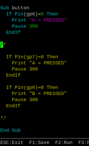

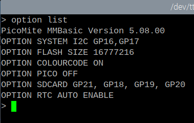

I'm using the newest release of picomite code and perhaps my error is not understanding the wording in the manual regarding multi line comments.

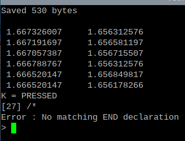

I am getting an error that I think is telling me the end of the comment is missing.
Here are the screen shots;
I just wanted to comment out a bunch of code, without the comments the code all works.
Thanks for your help guys.
Hans ...

I've just tried something similar and it looks to me as if */ isn't closing the comment.
On removing the multi-line comment marks the editor reverts to b/w too, although adding a new ' comment still colours that correctly. Other new commands aren't coloured.

' Funduino Version 5
' 3V switched on
SetPin gp6,intl,button 'K
SetPin gp7,intl,button 'A
SetPin gp8,intl,button 'B
SetPin gp26,ain
SetPin gp27,ain
'Print "Funduino Joystick"
Print ""
 Print Pin(gp26), Pin(gp27)
 Pause 300
Sub button
 If Pin(gp6)=0 Then
   Print "K = PRESSED"
   Pause 300
 If Pin(gp7)=0 Then
   Print "A = PRESSED"
   Pause 300
 If Pin(gp8)=0 Then
   Print "B = PRESSED"
   Pause 300

Posts: 12071
Posted: 10:48pm 29 Jan 2024
Multi-line comments can't be used inside subroutines and functions - this is a limitation of the way they work
