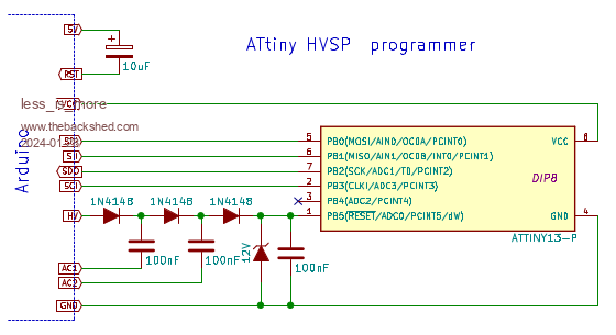

Waynes had already the idea to use a 12V charge pump based on arduino's capacity to generate ac.
His circuit has been further simplified to only 3 signal diodes,and 3 caps. Using a nano board, the generated voltage is 11.75V which is sufficient to enter HVSP mode. To stay safe, a 12V zener was added.
This is the resulting circuit   :
Taking advantage of both this charge pump and the special flash programming of Tyler, HVSP was achieved on a breadboard at first try!

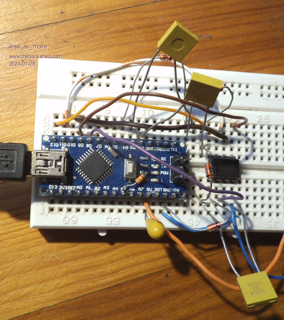

This was the first (and working!) attempt on a breadboard:

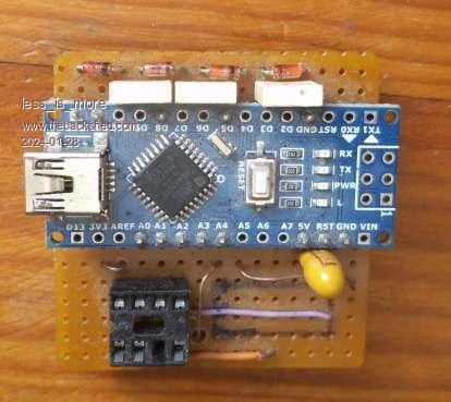

Now mounted on a stripboard with a nano, this programmer is the one I am using since 2 years:
Note there is an unpopulated place for a 14 pin socket, which was planned for programming Attiny24/44/84 chips
