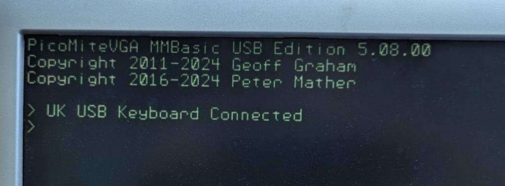

Please find attached a version of the PicoMiteVGA with USB keyboard support.
PicoMiteVGA.zip
Flash the firmware as usual
Connect a USB keyboard to the Pico USB connector using a suitable adapter
Power the Pico with 5V on the VBus pin (pin 40)
You can connect a USB-TTL converter as a console to pins 11 and 12 of the Pico (GP8=TX and GP9=RX)
The firmware will start as usual and assuming the connections are good will announce that the keyboard is connected. Connection works for me through a USB hub but the TinyUSB software may not support all variants

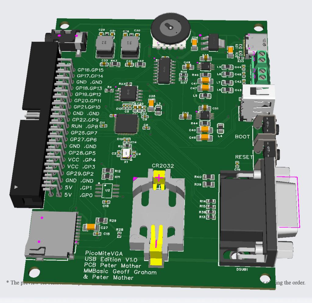

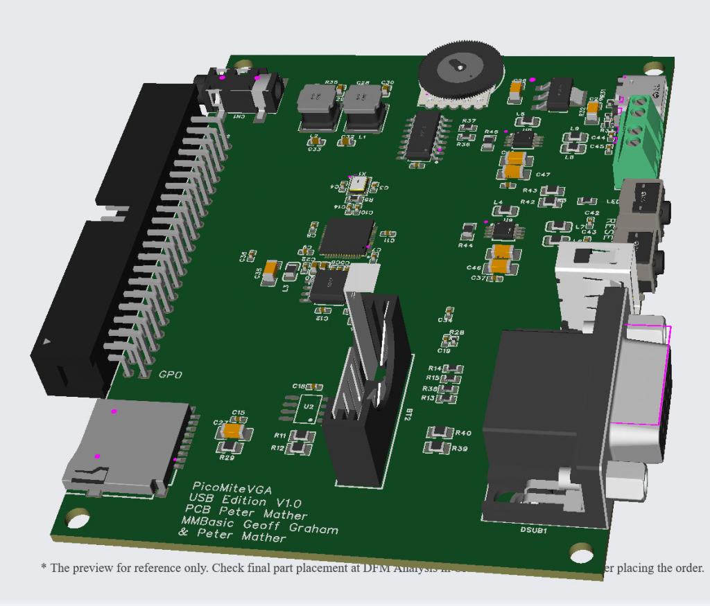

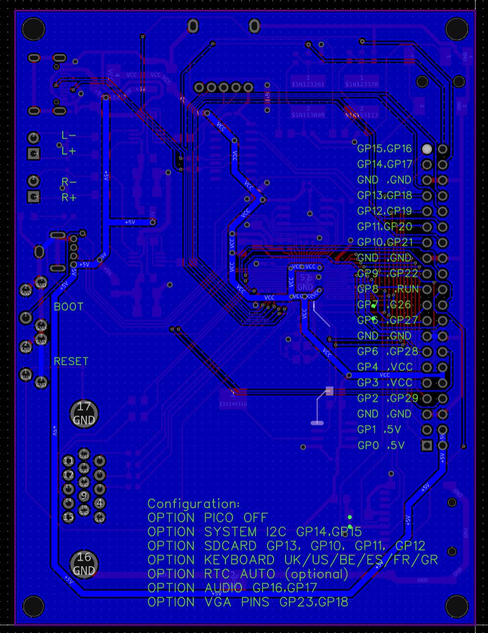

Here is a first cut at a layout for a CMM1.5 - just the components - nothing routed yet.
As per Vegipete's sugestion I've used an upright CR2032 mount but it looks very out of scale so I may revert to my favourite CR1220. Don't understand the issue with these. Widely available in the UK for pennies. The picture shows the DS3231 missing as JLC are showing no stock but LCSC have plenty so don't know why.
Schematic
d526a77b-1cb1-44b9-a0d7-183d33be6519.pdf
Price for 5-off fully built from JLC is just £66 + shipping. Bit cheaper than the CMM1 and CMM2!!!
Edited 2024-01-27 19:55 by matherp

Posted: 05:46pm 27 Jan 2024
Could you check something on that circuit diagram?
If you follow the the signal from pin 4 of the volume pot, it is connected through a 10uF cap to L4, then in series through C37 to U9 pin 3.
This differs from the other channel. Pot pin 2 only leads through C39 to U8 pin 3.
Posts: 12069
Posted: 06:12pm 27 Jan 2024
  Quote  Could you check something on that circuit diagram?
Thanks - it wasn't the only error in the amp circuit
I haven't found in EasytEDA how to cut and paste a circuit element from one design to another so I was copying by hand from a known working one but made a mess of it.

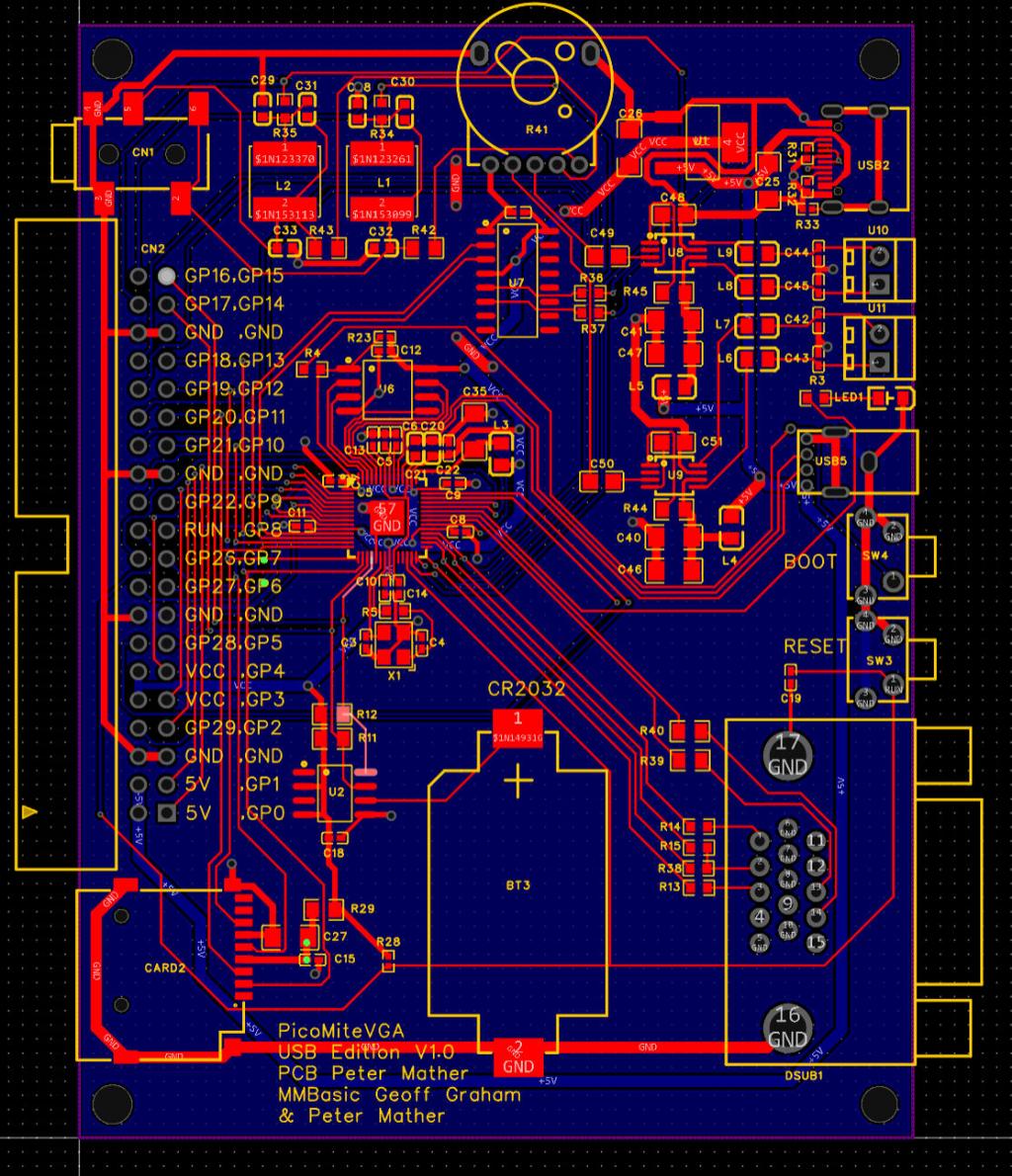

Posts: 6199
Posted: 06:18pm 27 Jan 2024
And U9 is powered between VCC and +5V.
Posts: 12069
Posted: 06:50pm 27 Jan 2024
  Quote  And U9 is powered between VCC and +5V.
Hopefully now all correct and all routed ready to get built. Because I needed so much edge space I've got room for a flat mounted CR2032 to please the punters.
The PCB is 100x70 and double sided so current price at JLC is £1.57 for 5 - how can they make them for that?
Total price for 5 fully built less the RTC chip is £63.25 + shipping so £12.65 each

Posted: 10:26pm 27 Jan 2024
Hi Peter, All,
Just a suggestion if it’s not too late, add 2 pads in parallel with each of the screw jacks for internal speakers in case someone want them internal to the box rather than externally connected.
Posts: 3417
Posted: 10:38pm 27 Jan 2024
1) They could just omit them and solder the wires on.
2) Turn them around so the wires are on the inside.
