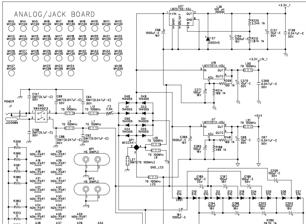

I need 9VAC from a battery. The simple route would be a COTS inverter to 220V and use the existing wall-wart. But how about using the Mite's PWM with a H-Bridge to produce the 9VAC from a 12V battery?

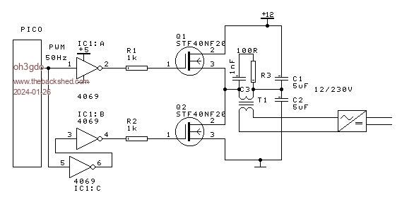

I remember at 1978, I did an inverter to my friend.
It used thistors, and hardware oscillator, but is was about the same as my drawing.
Regards Pekka

Oh, very nice. Those particular FETs are unobtainium, however.

It needs AC for the voltage multiplier. The waveform may not be too important though. What's the current draw? An amp or so at 9V?
PhenixRising
Joined: 07/11/2023
Posts: 2061
Posted: 11:04pm 25 Jan 2024
  Mixtel90 said  It needs AC for the voltage multiplier. The waveform may not be too important though. What's the current draw? An amp or so at 9V?
The existing wall-wart is rated @2.1A
Voltage multiplier? I figured it would be capable of +/- 12V and I would reduce it via PWM-ing the input....maybe I got this wrong(?)
Actually, the LMD18200t doesn't like a supply <12V so I can easily increase the battery voltage and chop it up with PWM....wrong track?
Edited 2024-01-26 09:05 by PhenixRising
Posts: 3364
Posted: 11:53pm 25 Jan 2024
  Quote  Voltage multiplier?
D11 to D37 string and associated capacitors are a x5 voltage multiplier.
As the main bridge rectifier has a large filter cap. (C66) the RMS supply voltage is incidental, what matters is the peak voltage.
9V x √2 = 12.7V
So a H-Bridge fed of a 12V battery supply will be fine, however there must not be any connection from the battery to the Analogue/Jack-board ⏚.
As it's a square wave put an inductor in series with one of the output legs, or low value resistor in series with the battery to reduce inrush current to the capacitors. The value will depend on the running current, 0.5Ω to 1Ω perhaps.
Headlight globes are good for this sort of thing. They have a low cold resistance yet limit the short-circuit current.
