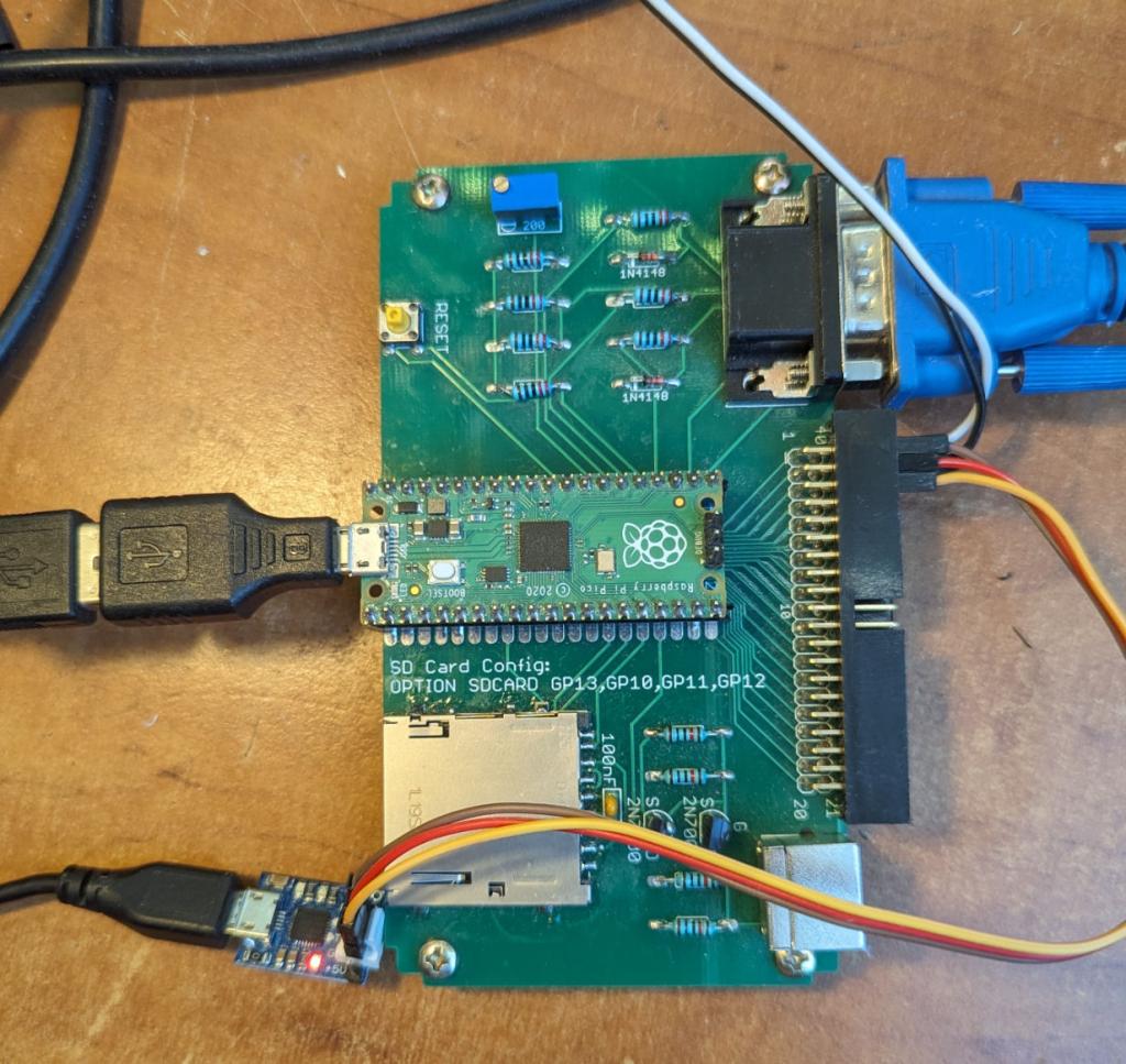

  for those of you following the HID2CDC thread, you'll have noticed that keyboard operation is getting close to perfect, and hopefully we may have mouse support coming along at some future point.
you may have also noticed that there are a whole load of unused GPIO pins on the second pico that are not doing anything... these represent an opportunity!
i'd like to be able to make use of these unused GPIO pins to extend the I/O capabilities of the picomite VGA. but to do this nicely requires the use of out-of-band signalling between the two picos. fortunately serial over USB provides for this, in the form of 'virtual' RTS and CTS signal lines.
is anyone in the position to create two small custom function for the picomite that can:
(1) turn the CTS status line on and off,
(2) read the status of the RTS line?
i have asked Peter and Geoff about this (https://www.thebackshed.com/forum/ViewTopic.php?FID=16&TID=16596) but received an immediate no.
using these custom functions it becomes possible to send data to and receive data back from the HID2CDC without it interfering with the normal use of PRINT statements or keyboard input. everything else can be handled by a few simple functions that are held in the LIBRARY as transparent extensions to mmbasic.
rob   :-)

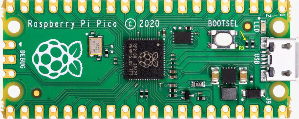

Hi All,
  Mixtel90 said  You realize that it's possible to re-purpose TP5 (the Heartbeat LED output) as an extra GP pin, don't you? It produces about 2V when set high as it's directly across the green LED. Best used to turn a NPN transistor on and off, giving an inverted output. Useful if you are stuck for an extra pin.
Of course you could always solder to the point shown by the yellow arrow below and get a full 0-3.3V swing on GP25. If you removed the Resistor labelled R3 you could also use it as an input, assuming MMBasic allows GP25 to be an input.
By Removing R3 it will expose a small pad to solder onto and allow `clean' access to GP25.
Mick (The big one)
EDIT***
Of course by removing R3 the LED will never illuminate.
Mik

Huh... I have a job even *seeing* R3, never mind waving a soldering iron anywhere near it!
Mick (The optically challenged one)

Hi Mick, Jim, All,
  Mixtel90 said  Huh... I have a job even *seeing* R3, never mind waving a soldering iron anywhere near it!
You are speaking to the converted here, I have about 6 pairs of glasses lying around, each has different uses. My favourite is an Optician quality that is somewhere between the cheap +3 and +4 that I use for soldering. It took a lot of convincing ‘Specsavers’ to do them as they were adamant that “that is NOT what you want/need old fella”
But seriously removing R3 is not that difficult and I would use single strand ‘wirewrap’ to solder to the pad and glue it to the pcb for strain relief.
All that said, I have not done so.
It was posted that it IS possible not that it is mandatory to do so.
