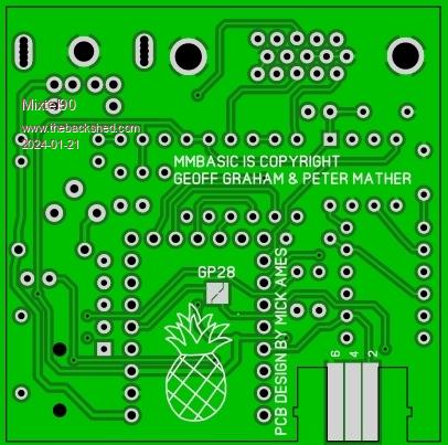

*UNTESTED* - HERE BE DRAGONS!
This uses Peter's facility to move the VGA pins to good advantage. It allows VGA output from a RP2040-Zero for the first time.
I wonder if, as the PCB is only 50mm square, this might be a contender for the smallest fully user programmable games console? :)
Sorry, no RTC on this one (not enough space), but it has got an expansion port.
GP28 (on the above) is, by default, used to detect a WII controller. If GP28 is high then a controller is plugged in and is the correct way up. There should be no damage if the controller is plugged in upside down as the supply is disconnected with this design. GP28 can be isolated from the WII connector via a solder blob link.

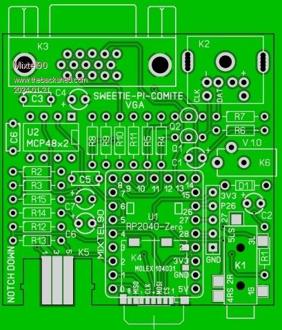

It *should* work with:
OPTION PICO OFF '(we need GP29)
OPTION SYSTEM I2C GP2, GP3
OPTION SDCARD GP29, GP1, GP4, GP0
OPTION AUDIO SPI GP5, GP6, GP7
OPTION VGA PINS GP14, GP10
Note!
The RP2040-Zero does not isolate the USB input via a diode. It might be a bad idea to power the board from the barrel jack while the USB is plugged in. There isn't as much need for a barrel jack when you have USB-C though.

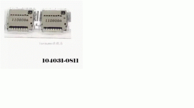

The 104031-0811 sockets are currently £3.38 + postage & VAT for 10 from AE. Not very expensive, just a little fiddly. I bought 20 a while ago as I decided to try to minimize dependency on ready built modules.
Posted: 04:54pm 21 Jan 2024
Can you provide a link? I've bought 2 sets which are wrong. The ones I'm finding now have a width of 14+mm, whereas the ones with that part number on Digikey appear to be 11.8mm.
Posts: 9246
Posted: 05:22pm 21 Jan 2024
see if this works.
The number printed on each socket is 131117A and the bag they came in is labelled 10431 0811. They are 12mm wide.
They look like the ones in the official drawing on Mouser's site, right down to the hole punching. They say they are 11.95mm wide, but my ruler isn't that accurate. :)

  Mixtel90 said  see if this works.
Thanks. I did not see any imprinted with 131117A, but I ordered this one
Posts: 9246
Posted: 08:34am 22 Jan 2024
They look like they might be the ones. They are all made in China anyway. :)

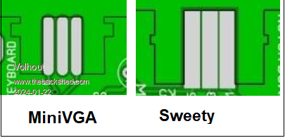

I have build few of your VGA board with the board edge WII connector, and before you release this one you may be able to "tune" the board edge connector a bit.
1/ the cutouts for the locks can be smaller and the edge facing outward can be 0.5mm more inward (when locked, the connector can still be pushed 1mm more inward). Tested this with a nunchuck and my (finally arrived) classic controller.
2/ the locks just "barely" lock. It is absolutely possible to push in the connector at 15 degrees, where only 1 lock locks. Maybe the edges that have the lock cutouts can be brought closer together to force the connector alignment.
I am not sure how much of this is due to JLC tollerances. Maybe you could check your board dimensions with the WII connectors (I assume you received these already).
Posts: 9246
Posted: 09:16am 22 Jan 2024
Thanks for the info. I'll have another look at the connector. I didn't have any official connectors when I drew the SL6 macro.
TBH I hate that arrangement and I'd much rather use anything else with the necessary four pins. Even Duponts.
The locking system is excellent when used with the matching PCB connector, but unfortunately it's a struggle to get those. I'm doubtful if they are even being manufactured now - we may be seeing old stock as they only appear to be used as spares for WII controllers. The last of those was made over 10 years ago!
I'm currently intending to use the official connectors on PicoGAME 4 but only because I'll get moaned at if I expect people to make adapters or change the lead for one with a RJ12 6P4C on it.

I've re-done the WII connector to a tighter tolerance after measuring the proper things. I'm doing a circuit diagram too.
