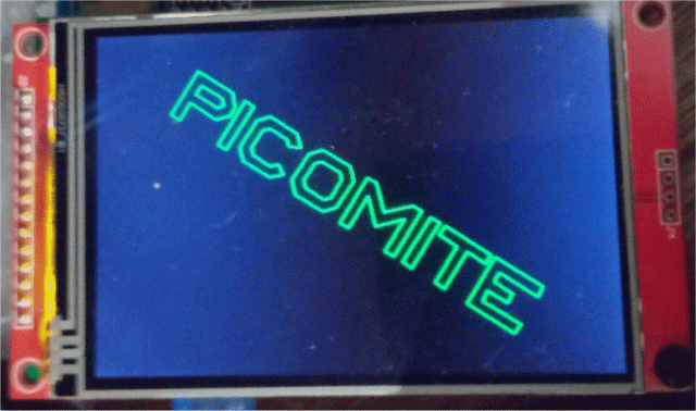

Posted: 06:05pm 21 Jan 2024
Like picorocks it's not right with ili9341 non vga latest
https://www.youtube.com/watch?v=D2EzyXflhks

Posted: 06:10pm 21 Jan 2024
Looks like it could be a timing issue if the program is converted from VGA to LCD.

Posted: 07:53pm 21 Jan 2024
Also works for me with ILI9488, though the speed of rotation is, uh, stately.
In some orientations, there are artifacts on the right and bottom margins. I don't exactly see what might be done in the program to fix that. Maybe pixels beyond hres-1 and vres-1 are clipped to those values.

Posted: 11:05pm 21 Jan 2024
Yes @lizby, ili9488 spin works like not enough volts, well slow but works.
is it slower than ili9341 or me?
Posted: 11:09pm 21 Jan 2024
  stanleyella said  is it slower than ili9341
With twice as many pixels to set with SPI, you'd expect it to be slower.
Posts: 3417
Posted: 11:29pm 21 Jan 2024
Added to that more colours (RGB666 vs. RGB565) requires sending 3 bytes per pixel instead of 2, slowing it further. Image quality has a cost.

Posted: 11:12am 22 Jan 2024
Have just run this on my GameMite with a ILI9341 display, clocked at 378Mhz I get an update rate of 30.6mS; at 252Mhz I get 34.5mS, so basically similar results, roughly between 32.7Hz and 30Hz, not at all bad, about half the rate compared to the VGA.
This would appear to be the upper refresh limit for an LCD, it appears that the Framebuffer copy takes about 30mS to send the frame update, so even using the 'B' option does not really speed it up, because the CLS and plotting is only taking a few mS, the rest is the screen data transfer. If I use the 'B' option, I can then place a 'Pause 22' immediately after the Framebuffer copy and it makes no difference to the update rate, so 22mS to do lots of extra screen plotting. ;-)
Edited 2024-01-22 21:35 by Bleep
Posts: 12071
Posted: 11:58am 22 Jan 2024
23mSec on an 8-bit parallel ili9341 of which 15.7mSec is the copy
Filled polygons
BOX 0,0,mm.hres,mm.vres,1,0
Before the copy
Edited 2024-01-22 22:26 by matherp
