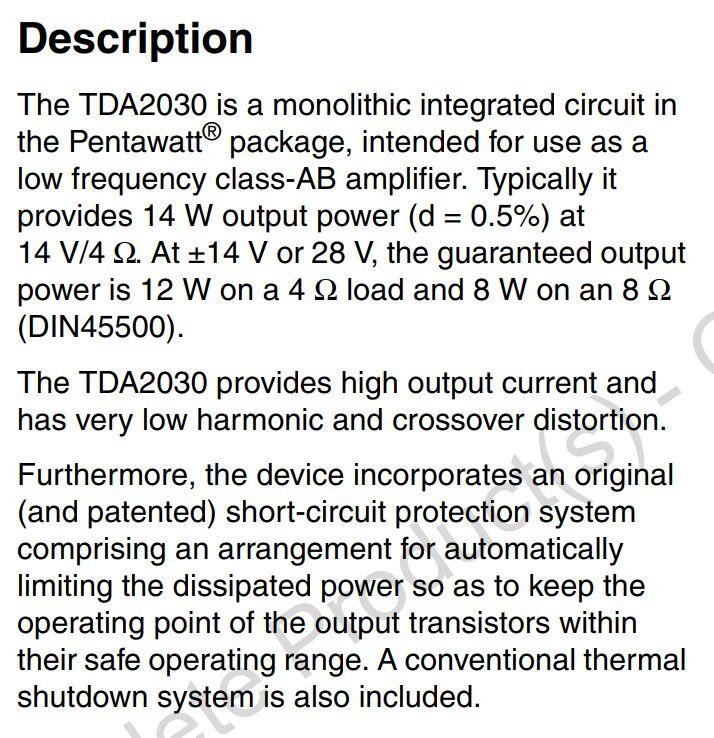

The datasheet does say this - which is where I quoted the stats from:
Looks like @ 28v, you can get 12W from it into 4R, which sounds reasonable.
Not sure what their quote above that is all about with 14W into 4R @ 14v, but perhaps it was a misprint.
Perhaps they meant 4W?
Posts: 3364
Posted: 07:25am 19 Jan 2024
+/-14V = balanced supply WRT 0V = 28V single supply.
