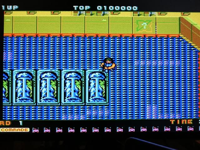

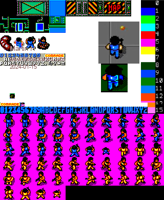

Hi
it had become a bit quiet from my side the last few weeks. But that doesn't mean I've been idle.  I'm still pursuing the idea of building an "Alien Syndrome" or Commando-like game for the Pico.
Since the sprites and tiles are not available on Github, this means that I have to draw everything from scratch.
Painting the whole thing from videos and screenshots is a very time-consuming task. Here is my worksheet of the last few days:
and a little Scroling Demo and Test of the Player-Animation
demo.zip
The next task is to draw more tiles and create the level maps based on pictures.
So it may well be that I need support at some points

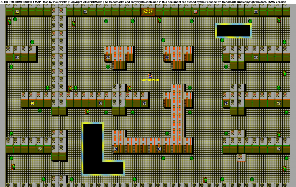

I found the Maps for the Levels but just as Pictures, so I have to draw the Tiles and then create the map files with a text editor based on the placing in the image.
like this Map1: (looks like the NES Version)
I think it could be a good way to use Excel for this Job using a Table with this Picture as Background.

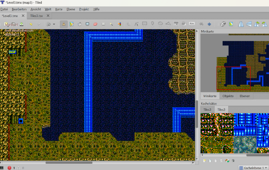

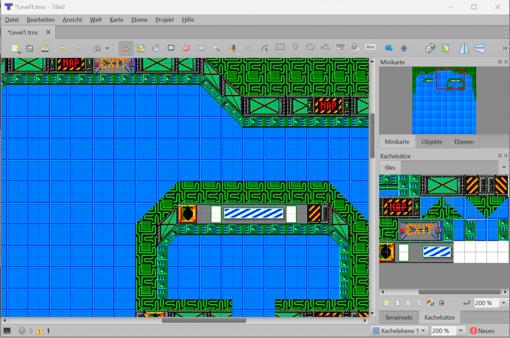

WIP...
After pixelpainting most of the Map1 Tiles, I think I finaly found a usual Tile Map Editor
Tiled, a flexible 2D level editor for games.
Two advantages that I have discovered so far, 1. you can change the tile template with a painting program, then it changes automatically in the tile, so you don't have to reload it in the Mapeditor.
2. The map can be saved as a CSV file, which can later be easily converted into a PetRobot like format
Have a nice Sunday
Martin

Hey Martin,
Tiled is the software I'm using to create the Knightmare maps as well. I wrote a small JS script (I have a python version as well) to convert the JSON to binary map-converter.js
How is the petrobot map format? I'm curious to know how the map data is stored

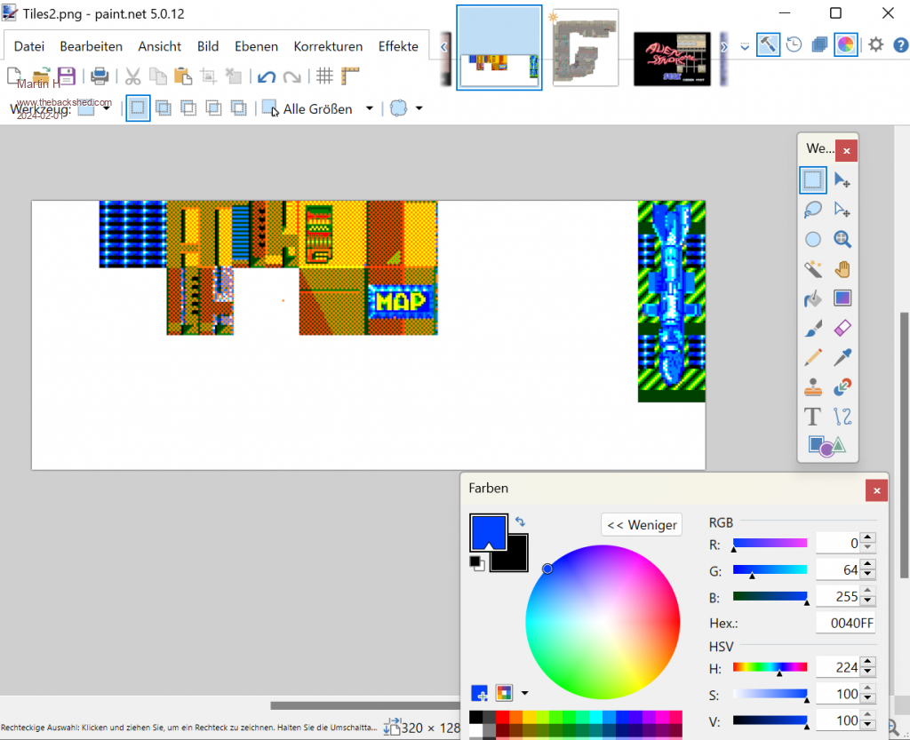

After I cut a march through video of the arcade version into single frames to get the MAP and the graphics. I'm about to create the tileset for MAP2 in RGB121 for the Pico.
You wouldn't believe how much time you can spend pushing pixels until you get a usable result

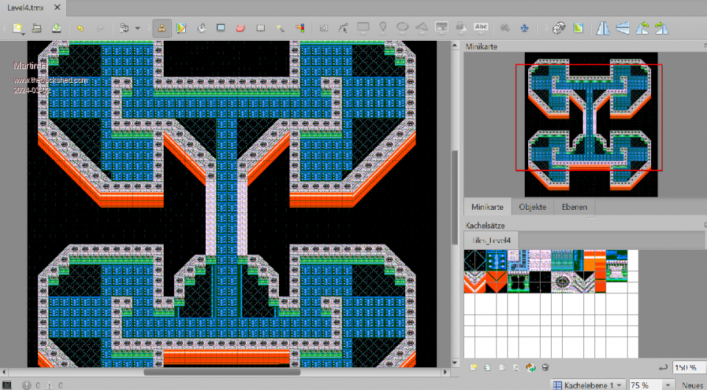

I have converted a complete [full walkthrough] video with Virtual Dub into individual images. Based on the images, I am in the process of creating the map for level 3
