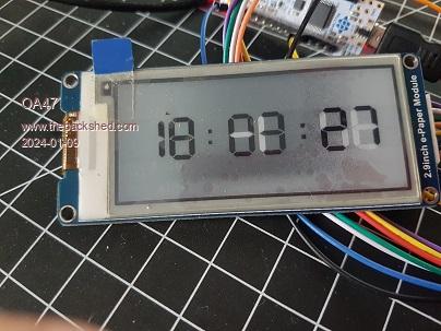

Can someone remind me how I clear a 2.9 inch e-paper Module that has random pixels set on it. I have run Peters clock program and it works ok but it only clears the pixels that are part6 of the fonts.

Worked it out. Got the brain cells to align.
> OPTION AUTOREFRESH ON
> FOR I= 1 TO 128: LINE I,1,I,296 : NEXT
0A47
Maybe premature victory. Even with BOX,1,1,128,296,,,FILL the screen is still grey in colour but running the clock program does leave the sections of the fonts as white.
Still may need some direction
Update:
FOR I=1 128:LINE I,1,I,296: PAUSE 100: NEXT
Seems to do the trick.

Update:
FOR I=1 TO 128:LINE I,1,I,296: PAUSE 500: NEXT

  Quote  Send this text to the screen on every line and see if it does anything.
Thanks Phil, I am still getting a grey background when I run the code even though the clock program does have a black to white transition during execution.

Here is the effect:

Posts: 3417
Posted: 10:58pm 09 Jan 2024
This bit of that link may be relevant to OA47's issue, the last sentence in particular.
  Quote  The displays are S.....L.....O.....W
A screen refresh on the 2.9" display takes just less than 3 seconds and somewhat over 5 seconds on the 2.7" display (note this is not significantly affected by the Basic code - re-writing in C wouldn't help). Also the displays flash from a normal image to an inverted one and back to a normal one as they refresh.
