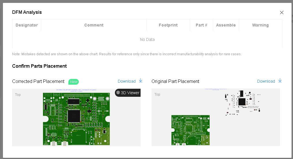

Posted: 01:34am 20 Jan 2024
In the PCB's I get made at JLC, the computer always puts the SDRAM chip either 90 degrees or 180 degrees out of alignment.
During the production process, JLC engineers correct that for me, and they always arrive with the SDRAM chip aligned correctly.  You can check the alignment just after payment, by clicking on "DFM Analysis" in your PCBA part of the order.  This only shows up in your order as a clickable link, AFTER the engineers have checked and corrected any alignment issues.  That shows the original computer alignment, and the JLC engineer-corrected alignment.
In any event, I have never had a problem, and JLC always supply the boards with the correct component alignment in my experience, and they have made hundreds of CMM2 G2 boards for me at this point.
CtrlAltSockPuppet
Joined: 05/01/2024
Posts: 16
Posted: 11:14am 20 Jan 2024
Interesting Grogster.
Mind if I ask what you do with so many boards?

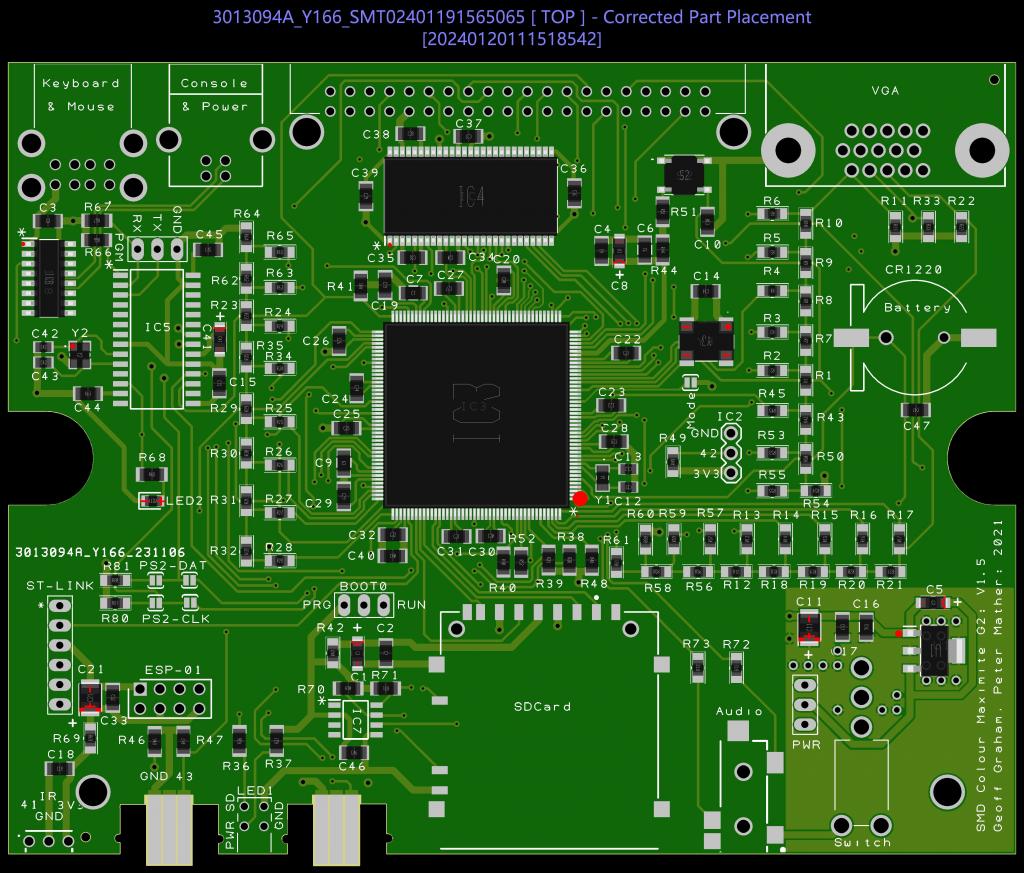

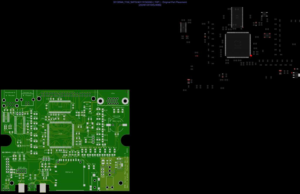

Posted: 04:15am 21 Jan 2024
I sell them via my website.
JLC assembles the top of the board SMD-wise, and when I get them, I fit all the through-hole sockets etc, program and test the board, put it in a case, and flick it off to whoever orders them.
EDIT: Here is an example of the DFM Analysis....
Note apart from total misalignment of ENTIRE parts placement, the SD RAM chip is 90 degrees out.
This is the image of the corrected placement by the JLC engineers.
I do not need to ask for this, they just do it automatically, cos they can see it is not right.  I guess they have a whole team of people that just check the component placements for PCBA...
Edited 2024-01-21 14:24 by Grogster
