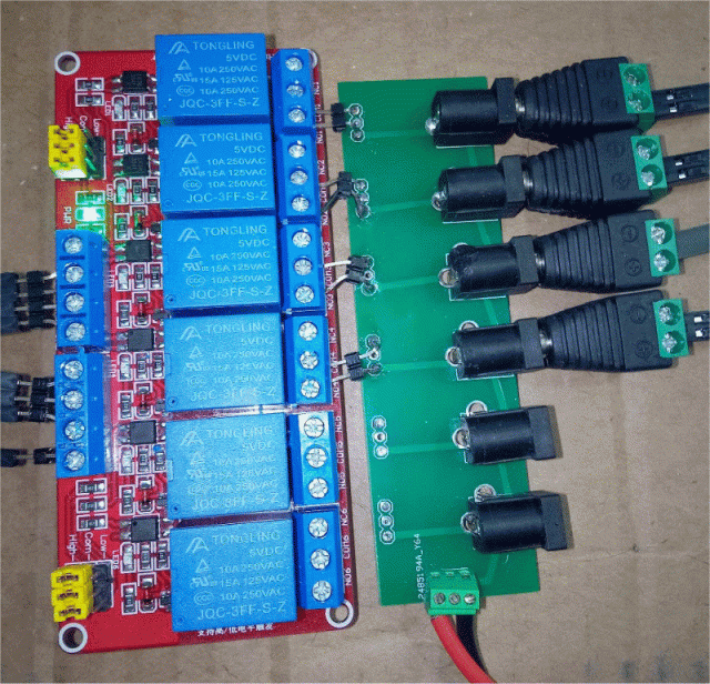

Panelization options still work in EasyEDA as shown in the video. I panelized (3x) a slightly modified version of this relay_module-to-powerjack PCB for switching 12-volt LEDs. Total price--$4USD--$2 for the PCB, $1.50 for shipping, and $.50 for Paypal payment option.
I can't swear that it will actually come out panelized, because the image shown by JLCPCB only shows holes and traces for one, but the size of the PCB show is big enough for the three. That is in accordance with what the youtube video shows.
Of course, you can't use this exact method to panelize different designs because EasyEDA wouldn't know where one design ended and the next one began. You could, certainly, place them with a V-cut between and panelize the combination--then all would be snappable.

JLCPCB sent an email saying there would be an additional $5.50 charge for panelizing.
I don't really need 15 of them (don't even need any, since I have some more blanks of the one shown), so I'll pass.
FWIW, that would be $.66 per board for 15 panelized versus $.80 per board for 5 unpanelized.
If you were doing 8 panels per board it might be worth it.

I've self-panelized before, and cut with my bandsaw. Actually, the PCB first shown is panelized with two to a PCB. But I don't have a bandsaw where I now am.
