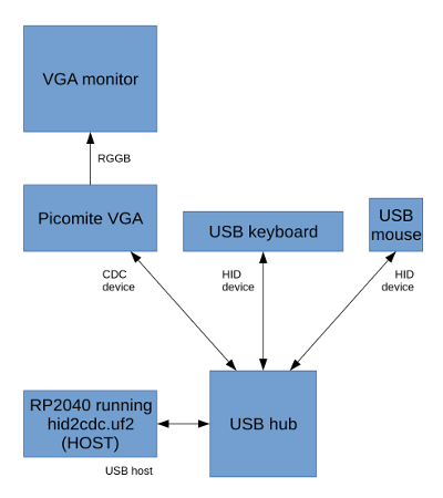

after raising the idea of using a host-configured pico as an interface between a picomite VGA and USB keyboard+mouse, NoOne (the author of ps2x2pico) has created a new github project to achieve this:
https://github.com/No0ne/hid2cdc
and created a test .uf2 file here for us to try out:
https://github.com/No0ne/hid2cdc/raw/main/hid2cdc.uf2
unfortunately he has proceeded just a tad faster than i expected, so i don't really have a picomite VGA set up to test it with
is anyone able to give the above a try? the parts should be plugged together thus:
keyboard input will be routed to the picomite's USB port as if from an attached PC, so no configuration of the picomite beyond enabling VGA should be required. i don't know if the mouse works yet (i doubt it). this is all just a proof of concept at the moment.
eventually it may also work with a CMM2, as an alternative way to connect USB mouse and keyboard.
rob   :-)

Posted: 09:20am 29 Dec 2023
the upstream port (on the flying lead) of the hub needs to connect, via an adapter, to the pico that is running usb2cdc.uf2. that pico also needs to have a 5-volt power supply feeding into VBUS (pin 40). this 5-volts is what powers the upstream pico, the hub, and all downstream devices attached to the hub.
into the downstream ports of the hub, you need to plug in:
1. a VGA picomite
2. a USB keyboard
3. a USB mouse (optional)
the VGA picomite needs to have a VGA monitor attached to see what is going on. if all is working, when a key is pressed on the USB keyboard, something should be displayed by the VGA picomite on the VGA screen... what exactly, i am not sure!
the upstream pico is effectively acting like a PC host would, the software of which:
A. reads keyboard scancodes from any attached USB keyboard, then,
B. converts those scancodes into ASCII characters (and VT escape sequences for function keys), and,
C. sends the resulting ASCII characters and VT escape sequences to any attached USB CDC serial device.
ultimately, i foresee the usb2cdc.uf2 also translating mouse movement codes received from any attached USB mouse into VT200 mouse escape sequences. this will allow a CMM2 (or PICO, with peter's consent) to have mouse functionality within the editor to the extent already supported when a terminal emulator is used.
rob   :-)
