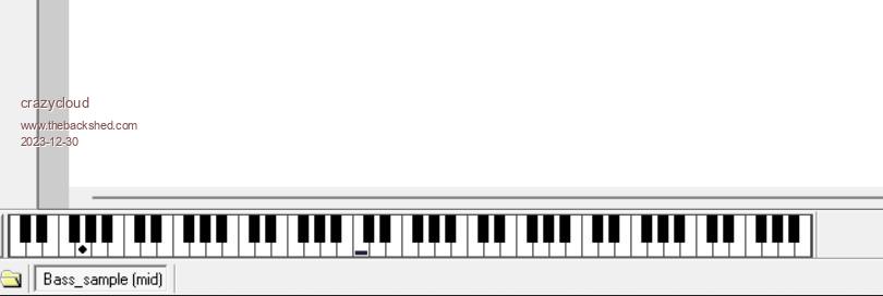

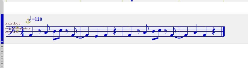

I just started using a program called "noteworthy composer".  You can import a .mid file. As it plays a staff is displayed on top with the notes.  On the bottom is an 88
key keyboard that indicates what notes are being played.  It looks like this.
I have a image that shows what keys are the equivalent midi note.  But this is kind of convoluted.  The equation method is much better. I'm having a lot of fun  playing the entertainer with many different instruments.  I have an extremely large collection of .mid files that could be used in games.
