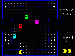

PicoMan - A PacMan look alike
You race around a maze eating dots while being chased by four ghosts who want to kill you.  There are four power dots and when you eat one of them you will have six seconds to chase the ghosts and eat them for extra points.  For every 1000 points you get a bonus Orange to eat for more points and for every 3000 points you get another life.  Eat all the dots and you start a new level.

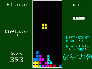

Pico Blocks - A Tetris look alike
This is the Blocks game that I included in the PicoMiteVGA firmware distribution but rewritten for the Game*Mite.  You rotate and move coloured blocks falling from the sky so that they lie evenly on the bottom and vanish.  However, don't let them build up too high.

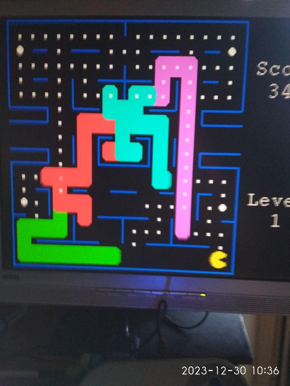

I launched the game "PicoMan " on PicomiteVGA (5.08.00b5), in general it works, but the moving ghosts are followed by taffy..
Best regards, Javavi

javavi and stanleyella:  These are for the Game*Mite NOT the PicoMiteVGA (or the CMM2 for that matter).
I do have plans for a PicoMiteVGA version but they are long term plans.
