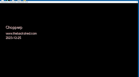

I tried the latest version on another W11 machine. Similar results with nothing on the screen in Mode 16. The keyboard seemed OK this time but the program crashed a few times while playing around.
I took a couple of screen shots to show the difference between the old & new versions.
The first screen shot below shows the display screen for the version a year or so ago. It has the standard 3 Windows buttons in the top RH corner & it sits snuggly into full screen & works well.

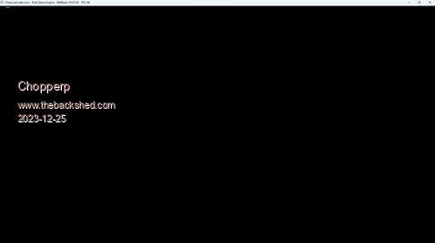

The second screen shot is from the latest version. It only shows the exit button in the top RH corner & does not sit snuggly into full screen as there is no button to click on to get it there. This does not work.
Something has changed in this area between the versions.
