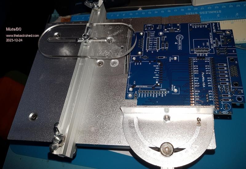

I've been trying to find a satisfactory way to do PCB grooving myself. also cutting "extra" boards off a big one or putting several small boards onto one 100x100 to save money. Putting a board in the vice, scoring it and bending it until it breaks is fine, but it makes a right mess of the edges.
I've just got a "Mini Table Saw" from AE and added a diamond blade:

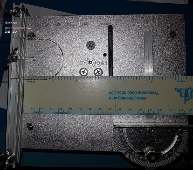

It's tiny, as you can see, but it's a "proper" saw and seems to work well. I've tested it cutting a board and also grooving one and the results aren't bad. It's a bit fiddly setting the fence up - it's rather crude.
Construction is very good. The main box is painted steel and the top plate is a hard aluminium grade, I think. The saw is mounted on a variable height bearing and a bracket off that holds the motor, which drives the saw via a double o-ring drive (some have a belt). The belt tension is adjustable. A 7-speed power supply is provided. Luckily it has a standard IEC inlet as the supplied mains lead isn't UK.
There are several versions of this on AE, superficially the same but they differ appreciably sometimes. Most importantly, this version has a variable height blade and there is a box beneath the blade that collects most of the dust. Not all are laid out like this.
I paid about £30 + tax for the saw (it's a very basic model) and about £6 + tax for a bag of 4 assorted blades (including a spare for the fine woodcutting one that comes with it). You can also get a TCT blade which might be better for cutting FR4.

Cutting board is a lot easier than scoring it, Stan. Also FR4 fibreglass board is *very* hard and quickly blunts metalworking tools. That's why diamond and tungsten carbide are used.. You can get along without stuff like this, but not if you want to be able to do even short production runs on the cheap.
I now have a few little board designs that I would like to try, but if I order them grooved so that they can be snapped off I'm charged for each design on the board, as well as for each board. With four or five designs the price adds up. This will let me put multiple designs on but only separated by silkscreen lines. That counts as one design. Then I can groove the boards myself.
I'd like to have some sort of mini dust extractor for the saw. It's something I'm thinking about. Doesn't need a lot of suction and won't be handling big wood chips so I'm sure something can be done.

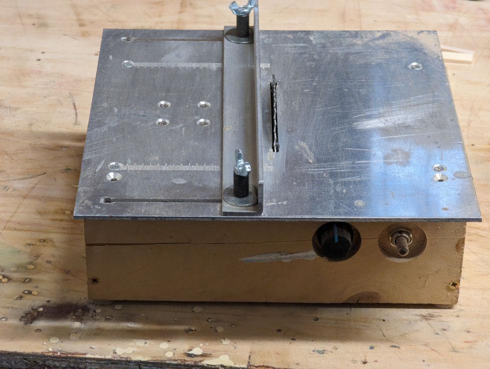

Posts: 12071
Posted: 09:46am 25 Dec 2023

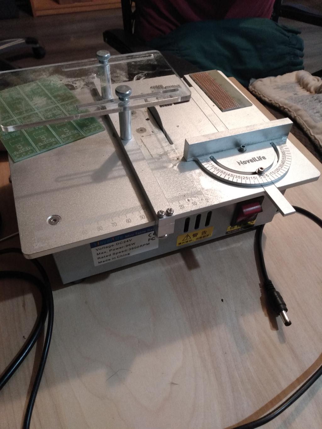

I made my own

Something I'd seriously considered. Eventually I decided that I could afford £30. :)
That's very nice. How did you get the fence distance rulers on?

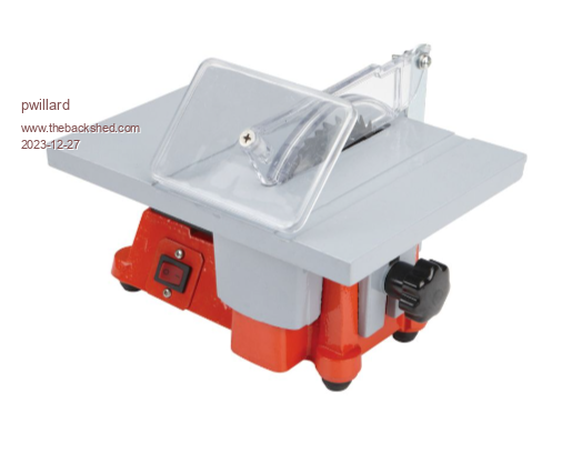

I've been using one from the local "Harbor Freight" store with a diamond blade for about a year now.  Love it.  Cost:  $30.00

I get envious of those who can get "Harbor Freight" stuff. Some of it looks really good value for money. Unfortunately I'm on the wrong side of The Big Pond and shipping charges make it uneconomical.
